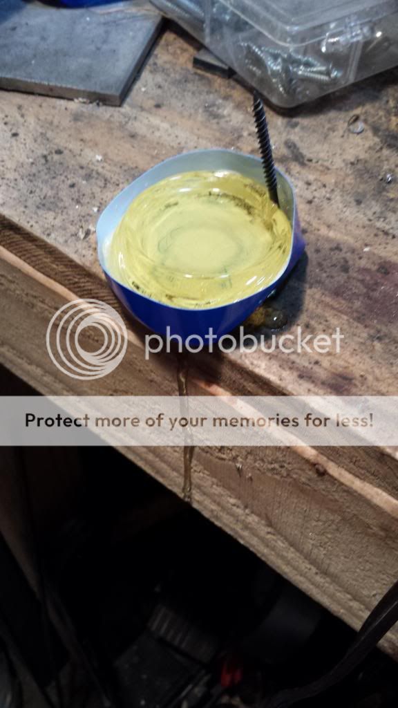

Ahhh the learning curve continues! Soooo don't leave a solo cup with acra-glass in it on the bench over night... sigh!
Yes, that is an epoxy hockey puck permanently attached to my bench

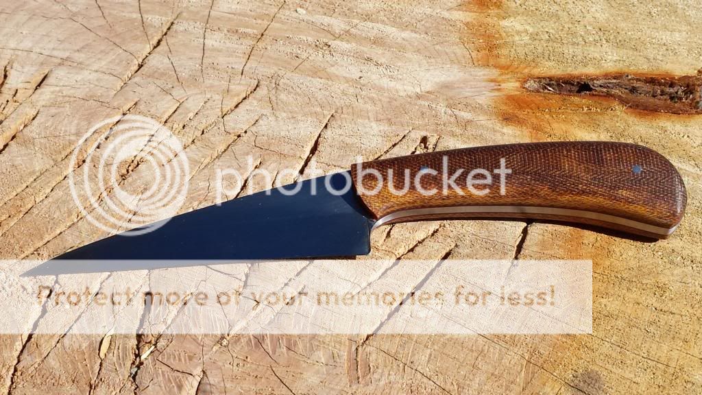

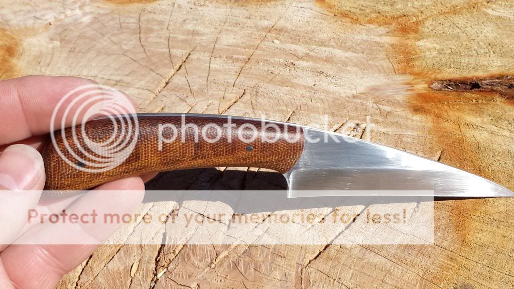

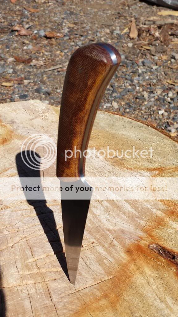

Howdy folks, so this is my first knife since I started reading this forum... I've made a couple others, but they were more "knife shaped objects" than anything else... please let me know what you think!
It's 1080+ that I got from AKS, along with natural canvas micarta and very thin red G10 liners (They don't have much contrast... too small I suspect). HT done by yours truly in my profane forge, tempered 2 times @400 in a toaster oven on a pan of vermiculite, once for 2 hours once for one (cause i forgot how long I was supposed to do it for the first time). Handle finished to 600 grit oiled with mineral oil and waxed with Johnson's paste wax. The blade is finished to 600 grit as well. It was nearly perfectly clean, but then I screwed up the finish after I put the scales on and realized I forgot to finish the spine... sigh... oh well it's all experience eh? Hope to not make that mistake too many times!
Thanks for looking!
