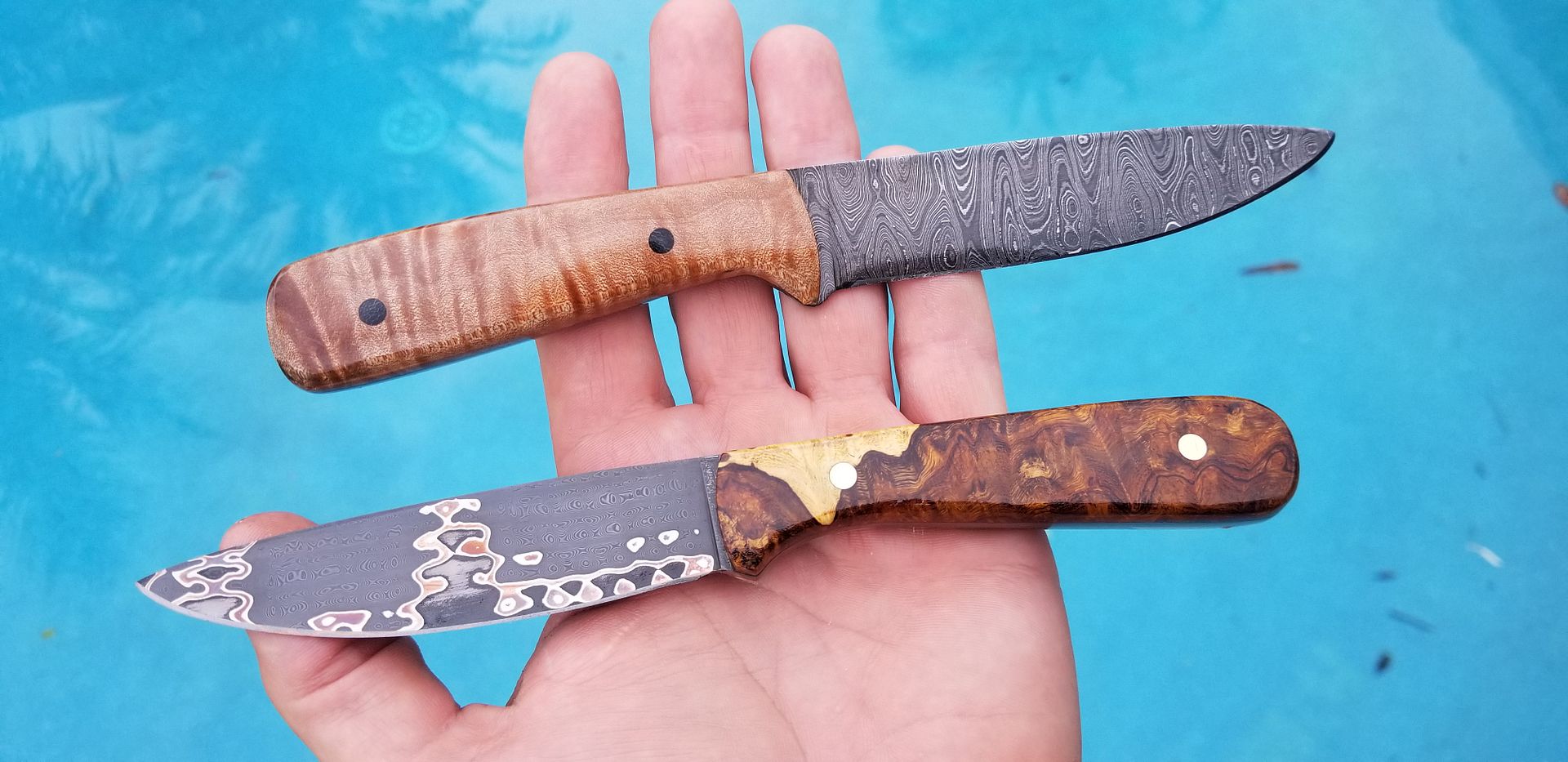

Working on something different a forged meat cleaver first one ,its intended use will be chopping BBQ meat. Second new thing I hadn't used 5160 it seems to be working pretty good for this application. Still have some grinding to do but it's testing well.
A little EDC Cleaver I made for my oldest daughter. It's my first free hand grind. Got a little HF 1x30 and I'm encouraged by the results. Made it by cutting and regrinding an old beat up chefs knife I've had since college. Gave it some new life. Still need to finish up the handle and make a sheath.
