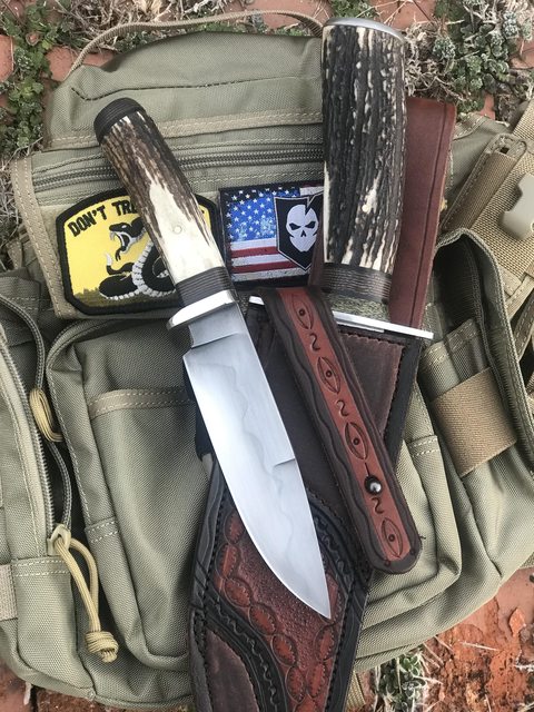

Here's my latest. Still got to put an edge on it but I couldn't wait to show you guys.
A 80crv2 drop point hunter edc type knife... somewhere in the 61-63HRC range. Tempered it for 62HRC but my hardness testing files only go in 5HRC increments. So it's definitely harder than 60HRC and softer than 65HRC. Definitely chomping at the bit for a heat treat oven, better tempering oven, and hardness tester. I don't like 80CRV2 at 58-59 so I am hoping this performs better. It's a thin grind - cuts paper already (albeit not cleanly of course). If I don't like how this one performs I may just completely switch to 15N20 for the time being until I am better equipped.
Black linen micarta with black and white liners - a look completely inspired to me by @Stromberg Knives - so I wanted to give a shout out. Stainless pins (god were those a bear to peen compared to the brass I am used to)
