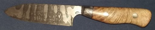

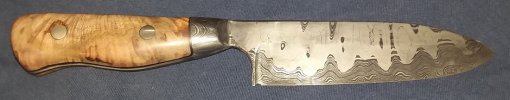

Here's what I just finished (minus final edge and sharpeneing). This is my second integral bolster and I was more focused on the damascus pattern than the blade shape. After grinding, I learned I had enough material that I could have turned this into a decent chef's knife. It looks like I need more practice forging to keep my billet centered. The last stack was 5 pieces (3 of 78 layer 1084/15N20 separated by pieces of 0.140" 15N20) and I was looking for bulls-eyes of layered steel on a background of 15N20 with a layered steel core/edge.

I'm not sure what to do with this one, may turn it into an EDC for me and abuse it for some edge/HT testing.
That looks great. I really like how the handle turned out.

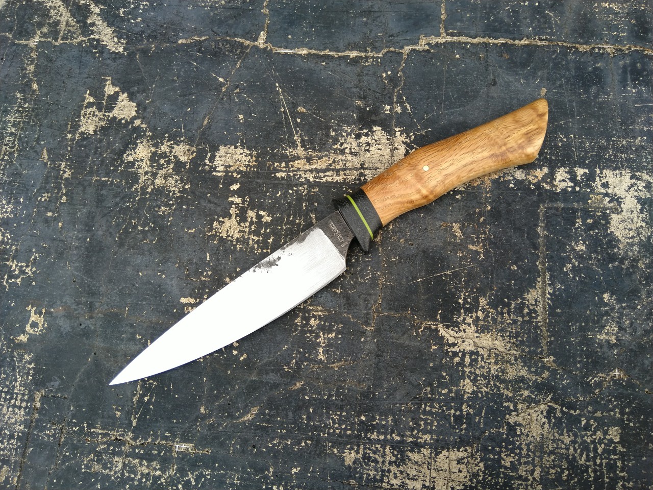

Everyone is really liking that maple. If you make more let me know. Those with the black stripes look fantastic. I wish I had found your add earlier and bought more.
