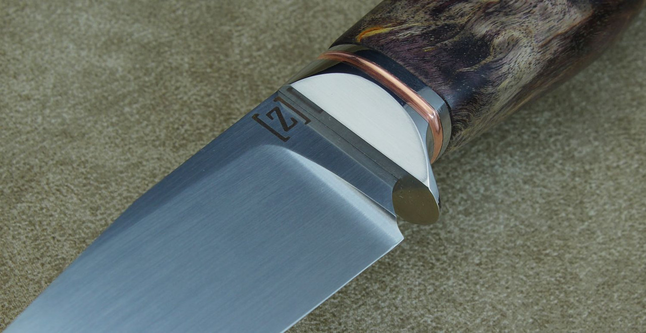

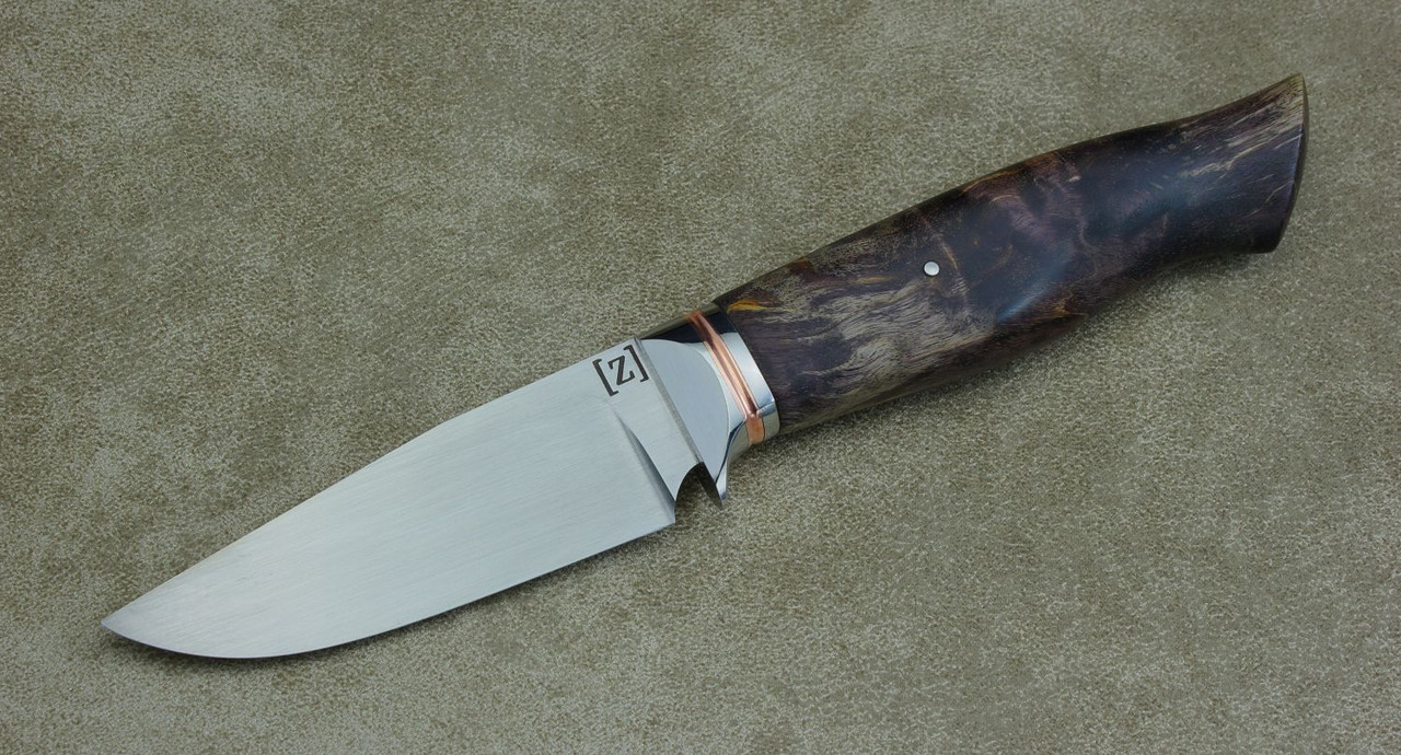

Your knives are always great to see. They are definitely what I am striving for. What grit stones do you use to sharpen? Thanks for posting. I hope you are enjoying your time in Europe. I have not been out of the U.S. since March and it is killing me.
Thanks
This one I just posted and it’s sold.
Generally king 1000 grit and king 6k or
Loaded leather strop... sometimes a Tsushima or aizu natural stone which is about 3-4k

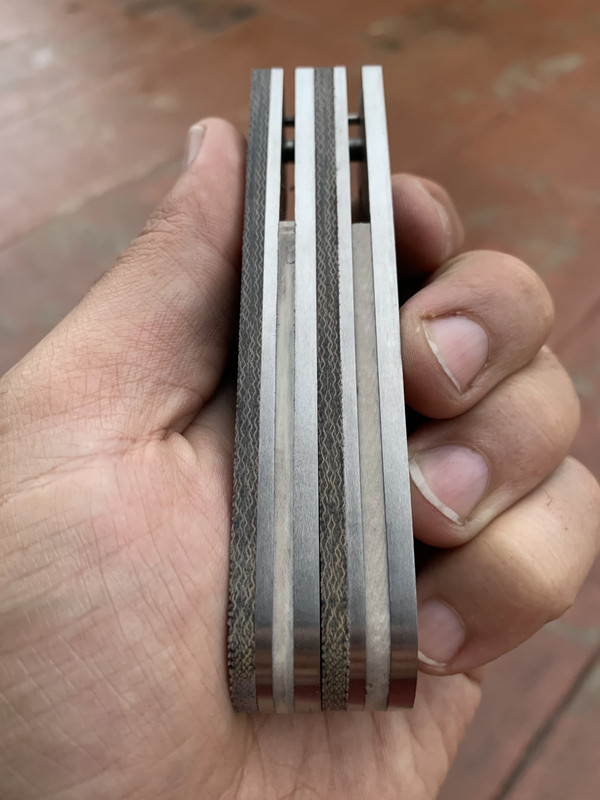

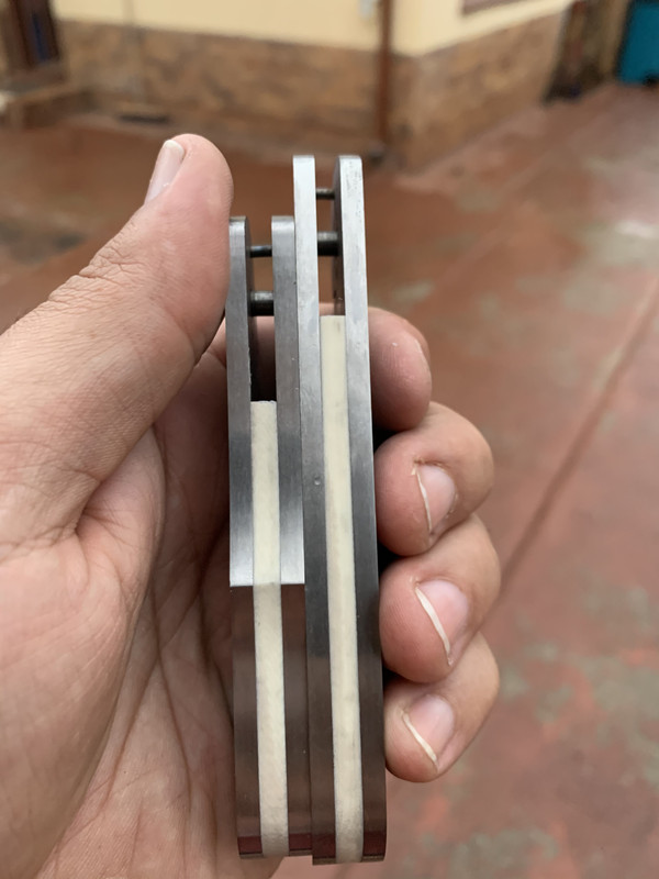

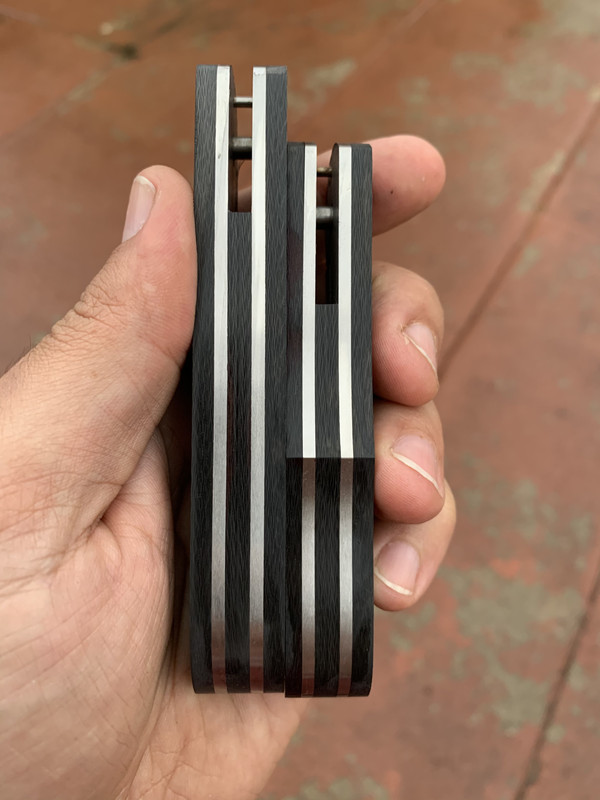

When I start glueing a batch and its friday (I don't go to the shop on weekends, its 25km/15mi away from home) I use 24hs epoxy instead of 10 minutes, its way more efficient. It properly cures over the weekend and I resume work on monday. Nevertheless I use 10min a lot more by far, and for example, with the unglued ones in the plastic box.

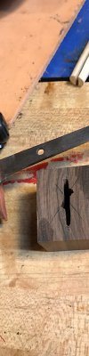

Started this Wa handle with dowel last year and blew out the walnut bolster at the tang slot.
I set it aside and forgot about it until today. Came across an old thread here with a solution. 60DC443E-3E7D-421D-B4CD-1F2184A660A8.jpeg
Now to make it a tighter fit.
