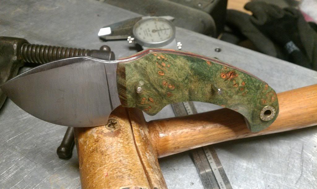

This is a WIP I am making for my Dad for Father's day. It will be my first handmade knife.
1095 HC with a flat grind, Maple burl Dyed Green Scales with a mosaic lanyard tube.
This is just a fit test. I have some blade surface finishing to do before I add the scales.
Hope to be done with it this weekend.
Thanks for looking.

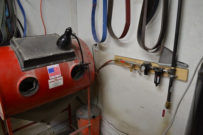

I have been busy... really busy! Here's a sample of what is going on in the shop. I also took some pics of my blaster setup for you guys to see, it works pretty well. I'm running 80 grit garnet.

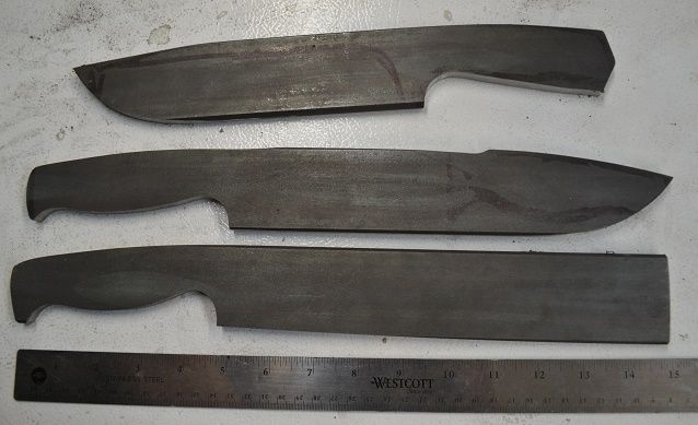

Here's another glance at the .360" Chopper batch. Competition Chopper at the bottom :D

Blast Cab Setup - notice the drops, valves, air dryer, regulator/gauge, exhaust vac, and Made in USA barrel blast cab!

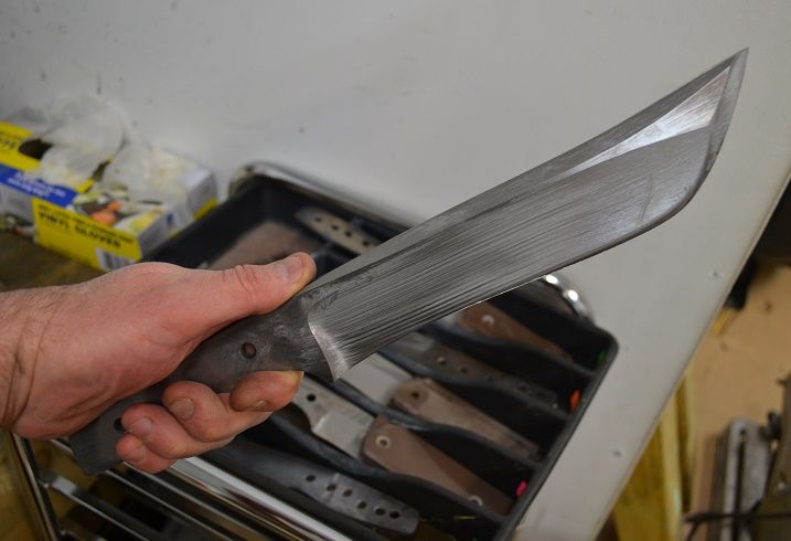

This is where I have been spending a lot of time lately. :D
These are looking beautiful! I have a lot of time into this stack...
Covered in white grease... the grease works great but is not getting used again! well, maybe for long term storage

I really appreciate you posting the pics of the sandblast set-up, I haven't ordered the Barrel Blaster yet because I got overwhelmed shopping for a compressor. I almost pulled the trigger on a 2 stage Quincy the other day, but a $1500 compressor for occasional blasting and a couple dropped air lines seems excessive. If that HD compressor is pulling its weight for you and all that blasting, it would be plenty for me! Thanks Daniel! :)
BTW- what was the white grease on the big sucker for? Was is just for rust protection? On polished/clay hardened blades that have to sit for awhile (here in the Pacific North Wet...er, um.. West) I coat them like that. It's a PITA to get it off, but not nearly as much as doing the etching & polishing all over again! :grumpy: :)

The blast setup works well but if I had to do it again I'd possibly consider a different compressor. I'm looking into a Max-Air unit. I'd say for most of us the one I have will do the job well.
I recently had some issues getting a part for it but it was resolved, after a huge wait I got a whole new unit! It is nice to have now but I am playing a lot of catch up at the moment. I'm on the fence about it. :D It's no big deal here but I am somewhat hesitant to recommend it after that. Overall it is a good compressor.
I sprayed on that white grease for long term rust protection while the compressor was down. I like to blast the tangs and scales before glue-up and have a stack of fixed blades just waiting. :D I was trying to wipe it off and later tried spraying on some generic wd-40, it wiped right off. I do think I'll use it again, the knives were as clean as can be.
By the way the Barrel Blaster is great, I really like it. A bigger dust collector is in store though, that little shop vac can't hang! I need a stool to sit on or maybe need to raise the blast unit, I'm about 5'9" and it is at an awkward height. I'd get ceramic nozzles too, they last much longer than the metal ones.
