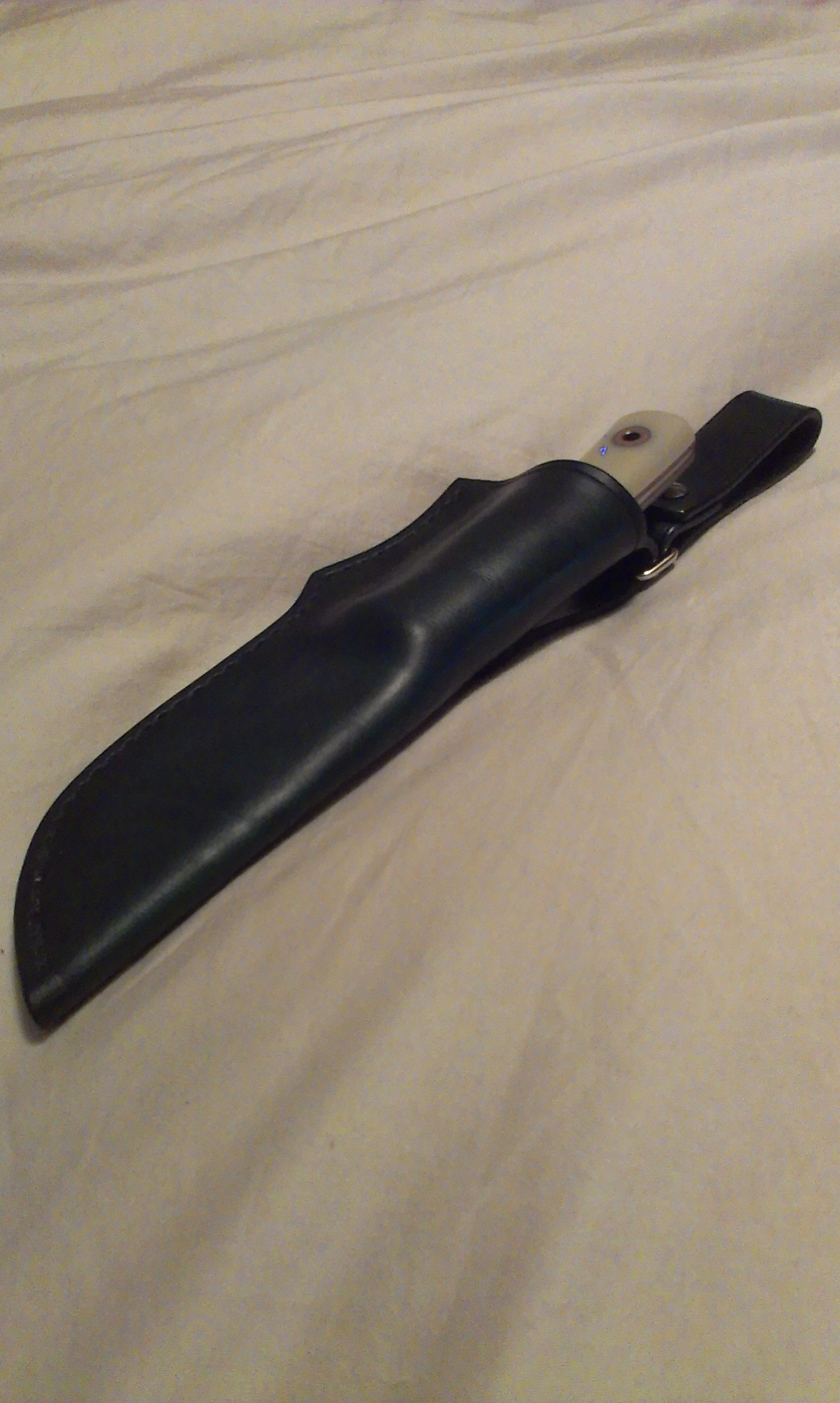

Sheath work!
I've been making sheaths.
Man Butch, that thing is AWESOME!!! :eek: :cool: :thumbup:

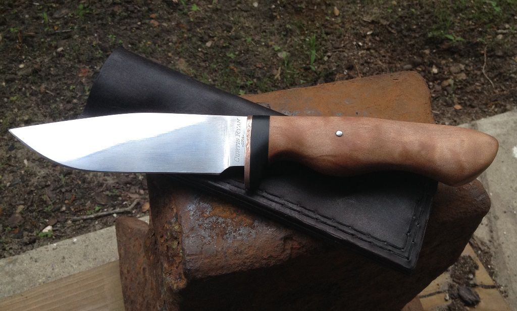

Finished up this knife for my stepfather who just finished radiation treatment. He hasn't seen it yet but I think he'll be happy with it. The guard is the mokume gana that I posted a couple of pages back.

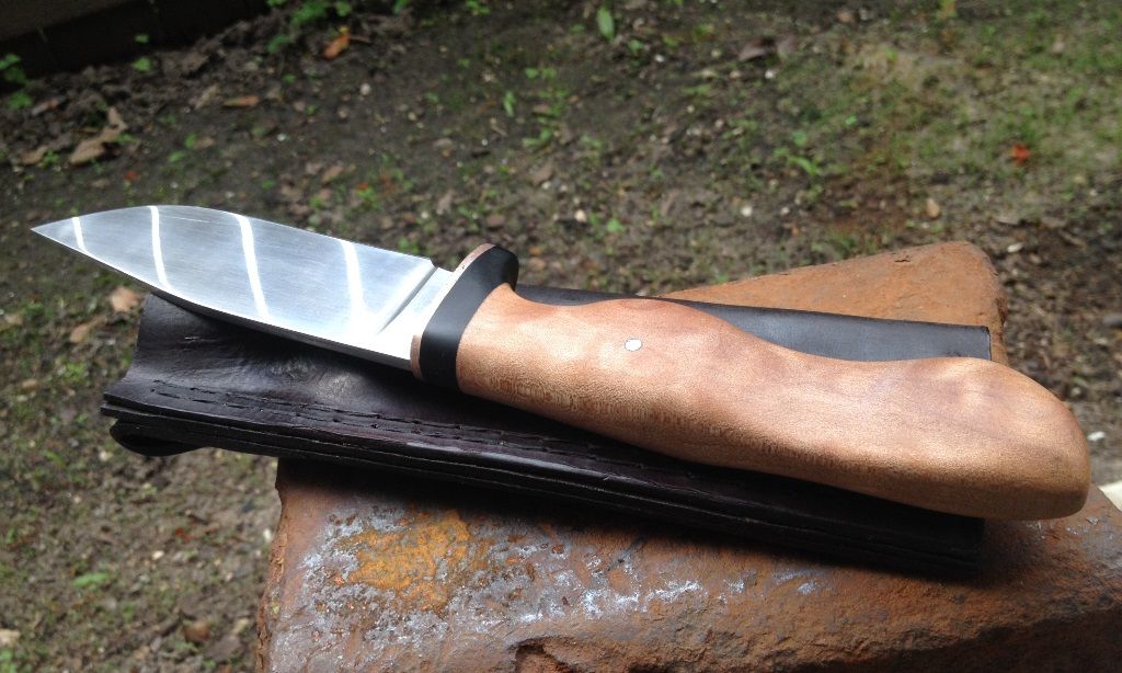

I have watched lots of videos, to see how people dress, skin, and butcher deer. Seems like everybody has their own way of doing it, so there is a wide variety of favorite hunting knives out there. I designed this one with lots of belly, just for the heck of it.
I made a wooden mock-up first. The mock up felt excellent in hand. It is A2 tool steel.
It's all hand filed, using a jig.

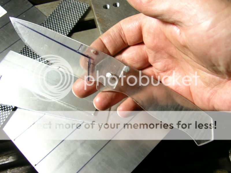

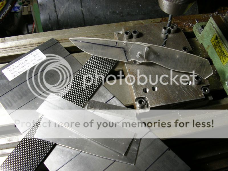

Mike - Twice I got talked out of buying the "standard grade" Ti and bought their "Knifemakers grade". How's the "standard" working out for you? Do you have a surface grinder?
Thanks
Mark, I do not have a surface grinder. As far as I can tell the Ti looks very flat. However, I have not profiled or drilled holes in it and that may cause some internal stresses to change the flatness. I will keep my fingers crossed and hope this is not the case.
