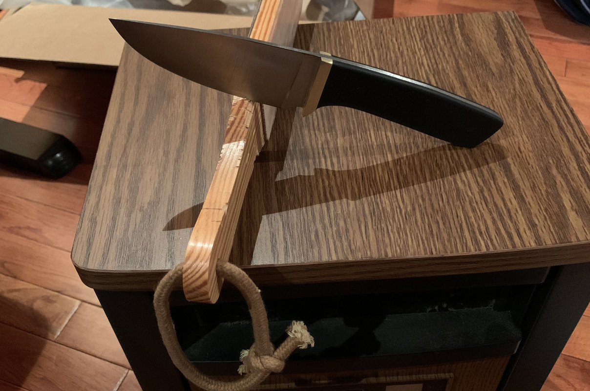

This one has a 1084 carbon steel blade, black G10 liners, G10 pins, and a brass guard.
Very elegant!!
