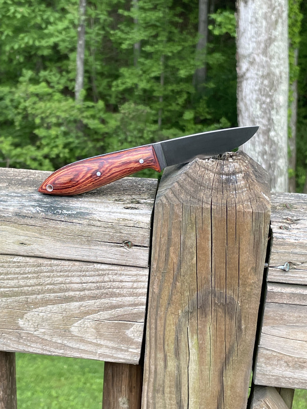

Made this little EDC for one of my young daughters. It’s made from raindrop pattern Damascus I got from weo weo . The handles I think are dyes and stabilized curly maple. I went on a scale buying spree a while back and that’s what these are, as best I can recall. I had the spine etched with the blade and shaped up the scales as best I could before gluing them on. But my inexperience shone through and I boogered up the spine while putting on the finishing touches, so I just brought it to a mirror finish. I may try taping the handles up and re etching the spine.
