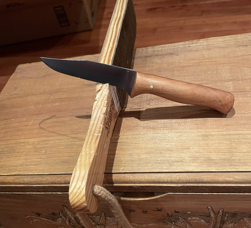

First time tapered tang and first time hollow grind. A bit shaky but I am getting there.
