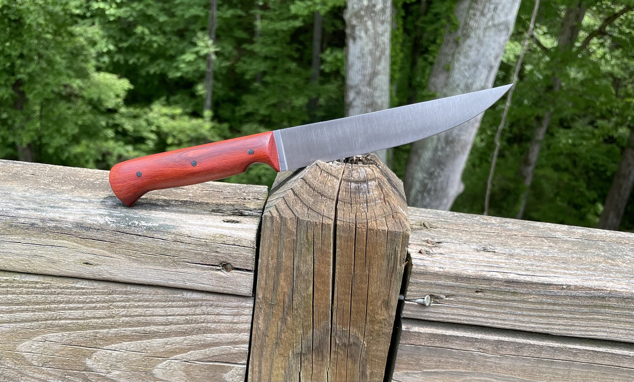

It really is not turning out how I had hoped, but it taught me a lot. I was hoping to see a nice bevel line, but I ground it out too much by hand. I'm practicing using my 1x30 and will grind the bevel on the next knife using that.
If you ever make a knife that you are totally happy with, you should quit while you're ahead.
You did well. Treasure any difficulties and mistakes as learning experiences. And then, of course, strive to not repeat the same mistake. :)

Ekims tutorial is awesome. There are other good ones for chef knives, basically you wanne angle the tip 45 or more degrees down when grinding (if grinding edge up) to have a long (not cut in plunge). Then you feather the transition in.
