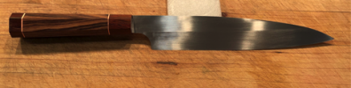

FINALLY had a chance to finish up (mostly) this knife - this one for me. Only took me a year or so :-(. A Yanagabi, 26C3 @ 64 rockwell, 9 inch blade, 0.1350 stock at the spine (which seems thick to me, but every time I check is consistent with the commercial knives I can see out there. Handle is Kingwood with cocobolo butt and bolster, copper spacers (I LIKE Kingwood.....) . Still have a little touch up to do (filling in a couple small gaps in glue at the bolster/ricasso joint), then final sharpening... Still not totally satisfied with the profile, especially at the tip. but I am hesitant to mess with it more at this point.... THIS is the blade for which I constructed the wooden radius platen to create the Urasaki. Im not sure if the hand sanded satin finish is really needed, as the sharpening process, which appears to be particular to single bevel blades with a Ura, inherently leaves significant sharpening marks (top and bottom of the Ura side, and on the entire bevel on the single bevel side. Still - I am curious to see how the sharpening turns out - as the basic geometry and sharpening process is essentially that used for straight razors. All indicates are that a properly sharpened Yanagiba is SHARP.... (I might need to make a Saya for this one...)
(BTW - the curious thing about the last photo is that is *looks* like the right (as viewed in the photo) side of the blade is the bevel side .... but what you are actually looking at is the curvature of the Ura on that side (which would be the left side if you were looking down at the blade as you hold it), the other side (left side as viewed in the photo) is the flat of the single bevel - you actually do not see the shinogi or the flat)

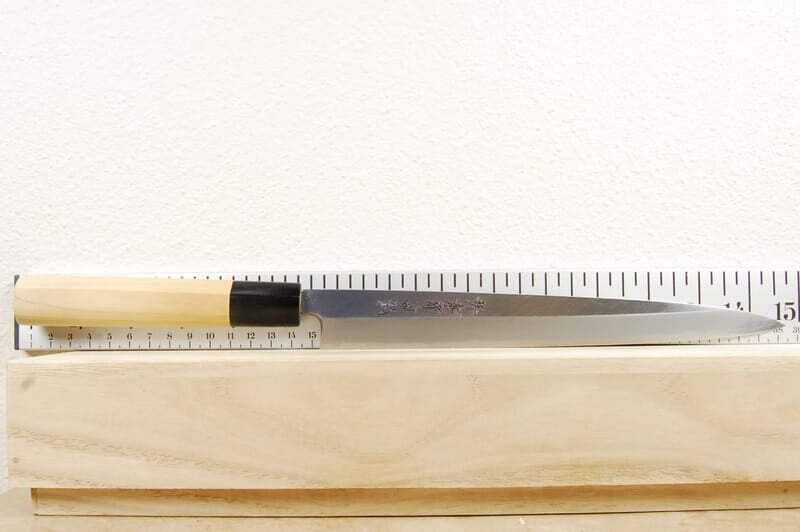

Cushing, how tall is the blade at the heel? Most yanagiba are only around 1-1.24" tall at the heel for a 240mm blade. Here is a pic of a 240mm yanagiba I found online. It's around 29mm at the heel, 3.66mm thick. The spine of the yanagiba is an almost straight shallow slope down for the first half of the blade and then gradually gets steeper towards the tip. The edge profile looks good, yours just looks pretty tall for a yanagiba; its like a cross between a funayuki and a yanagiba?

It is 1.5" at the heel. Honestly, i profiled this out so long ago that i dont remember where i got that dimension from. I would have looked at japanesechefsknives.com but looking there now, the knives posted agree with your stated range. To quote horesewright ... quien sabe... narrower would definitely look better.
This knife was always really intended to be a "trial run" towards ultimately making a 300 mm yanagiba - which is what i REALLY want , so im not going to cry about this one (it should still do a decent job...). :-)
Yeah, it will cut well! Sometimes I struggle with blade shape/dimensions and getting it to "look" like I want it to! It's amazing what 1/4-3/8" will do in terms of profile! The yanagiba are strange to me being fatter and shorter height wise. I like a taller sujihiki myself, but it's harder to get the profile looking right.

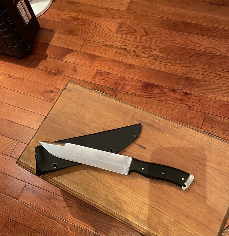

Here’s a Bowie I’m finishing up. This one has a 7” 8670 carbon steel blade, and gaboon Ebony scales.
