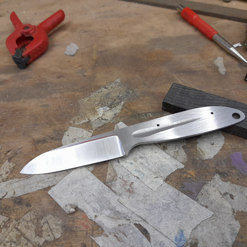

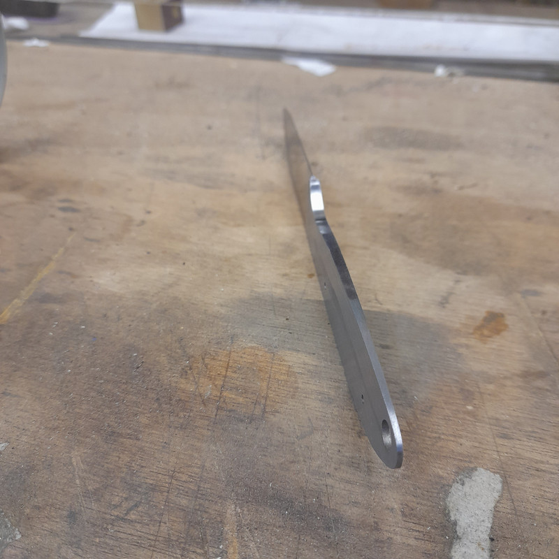

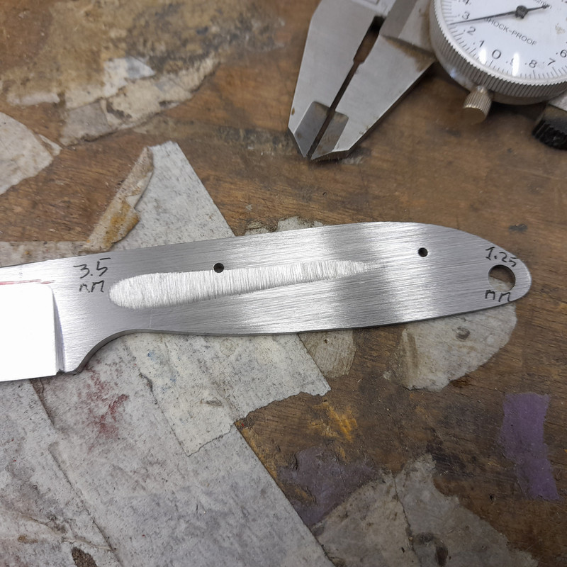

Well I was happy with the hollow grind, so lets try something fun, a tapered tang!
My first one and I realy enjoyed doing it!
I kept just a bit over 1/3 of the original thickness. I think it screams out for a handle with liners to show off.
