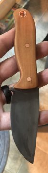

I haven’t sharpened it yet but other than that I finished this little skinner I’ve been working on over the weekend. The blade is heavily oiled in the pics but you get the idea. I used some cherry from a tree my dad cut about 10 years ago for the handles.E8E9C55C-05DF-4C1F-BCC4-7807E7389270.jpeg0F277F35-ACAE-455E-8D51-8EA83A5E67A6.jpeg

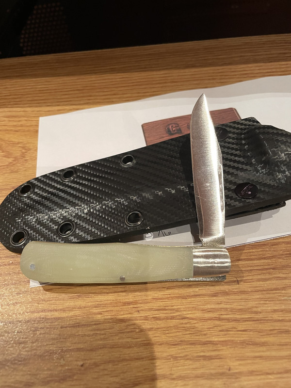

My first slip joint folder. This was quite the learning experience. I used a scrap piece of A2 for the blade and spring. My original plan was to only put jade green scales on it, but I ended up having to use some of my nickel silver for bolsters because I drilled a pivot hole in the wrong place. Any advice on adding nail nicks without a mill would be greatly appreciated.
Looks good! The best success I had with nail nicks pre-mill was to pick a design that didn't need nail nicks ;). Seriously though, I had good success making long pulls with a dremel cutoff wheel in a drill press with a junky cross slide vise. It turned out much better than I expected. I used a dressed dremel cutoff wheel and files/paper to do traditional nail nicks, but only got so good at it. Certainly functional, but it eventually became the weak aesthetic point of my work. I tried using punches, but never got that quite right. I found it hard to get the depth needed without overly chipping the punch. Then I got a mill... I still use my punch to crisp up corners off the mill. I never tried it, but it would be intriguing to use a dremel/files to get the depth and shape needed, and then use the punch to crisp up the corners. Nail nicks were the bane of my existence for several months at the beginning of the year.
