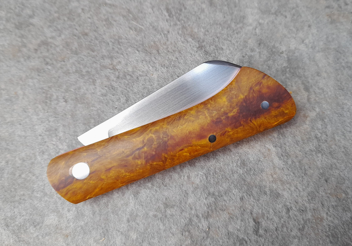

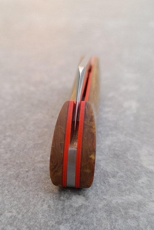

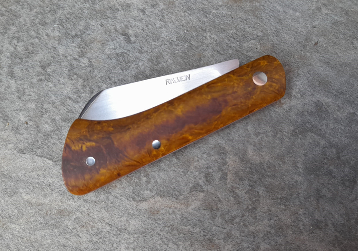

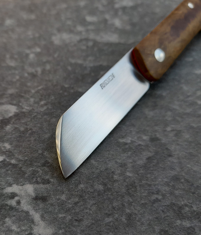

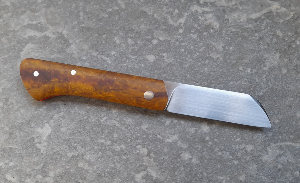

I'm working on two knives for other people and in the downtime I've been working on my 10th slipjoint.
Thin hollow ground RWL34, 3 5/32" closed wit a 2 3/16" blade. It is designed to have flowing lines when closed. I like how it turned out, I'll EDC it for a while. There are enough improvement points, but I'm getting better.
Do you like the handle material? It is genuine WW2 rag micarta with dark patina :)
That's some of the most beautiful micarta I've ever seen.
this looks really nice. just by chance, is the pattern available anywhere, or did you design it yourself? I would love to try and make one like that.
It’s a pattern that I came up with, modified slightly from the Tony Bose pattern posted on Chris reeves web sight.

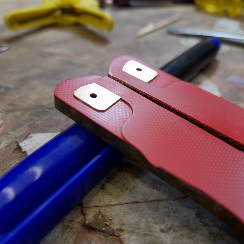

Cool washer setup. I have to process what I am seeing here a bit.
Thnx. It is a 0,5mm layer of G10 with a 2nd 0,5mm layer on top with a recess in which a 0.5mm piece of bronce is placed.
It is my way of relieving a liner without a mill.
