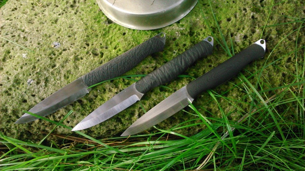

3x Skylark ready :)
Steel: 80CrV2 3mm
Hardness: 60HRC
Scales: Sandblasted G10
How its looks ?

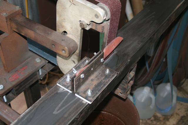

Been working on a new stand for my KMG to accommodate an extra-long work rest for jig grinding waterjet cut bush sword blanks.
This Little Rok is the first of my waterjet cut blanks to get ground on it. Still a bit of tweaking on my process with the new setup, but I think I'm most of the way there.

James- that's a MAN sized tool rest! :D
I have some man-sized mid-tech bush swords I need to be a-grindin' on. :D

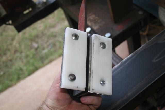

I modified my test jig with polypropylene bearing surface sourced from a Wal*Mart cutting board, held on with the motley assortment of bolts I had around the shop. Slides much better without being too slick.

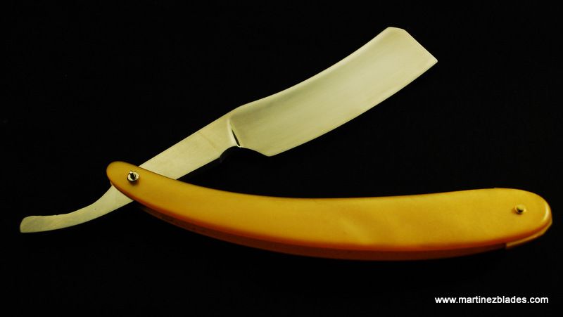

Working on another finger-numbing razor. So far its at 2000 but I'm taking it back to 1200 for a proper satin finish after etching the logo and touching up the tail grind. Again, the scales are being held together temporarily with micro-screws as they were being fitted. Now that they are sure to work well with the razor, I'll finish shaping and sanding.
