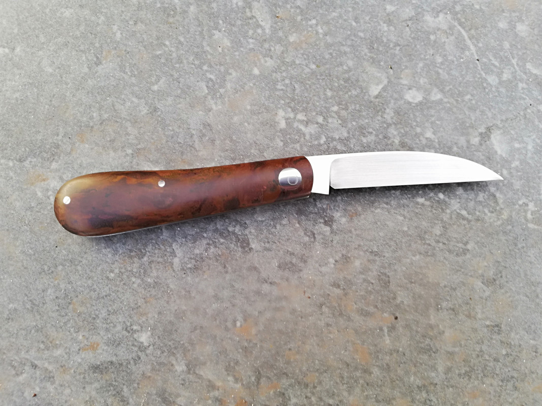

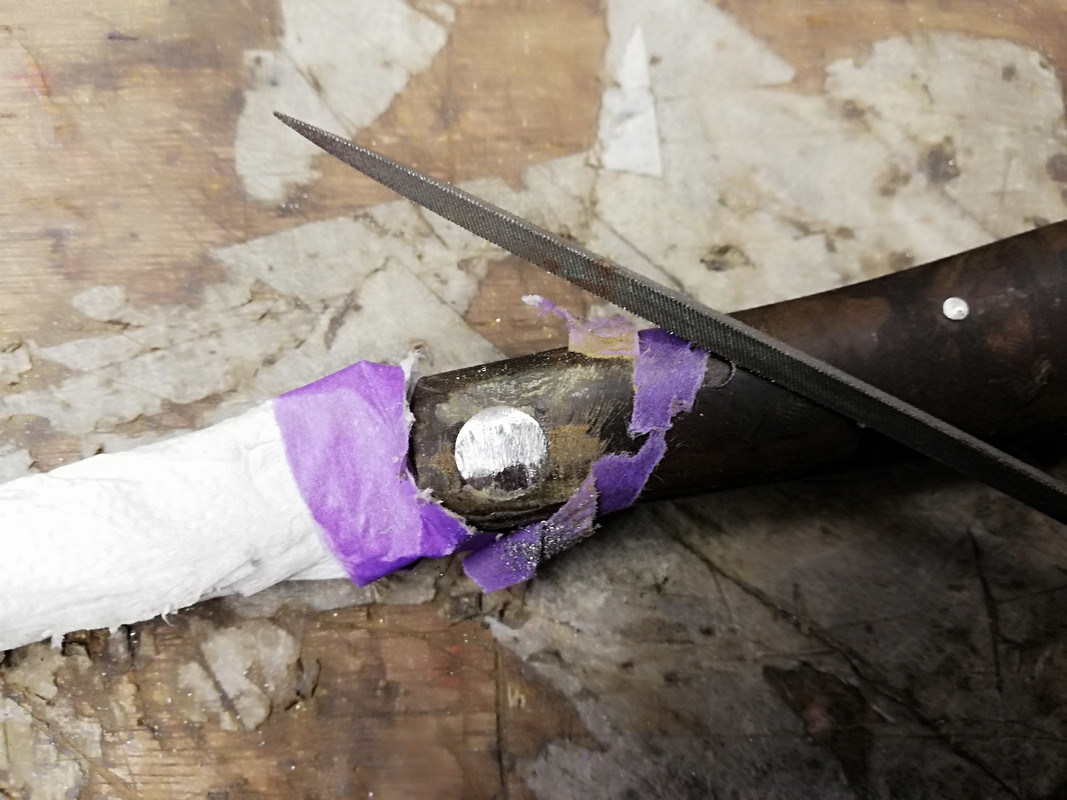

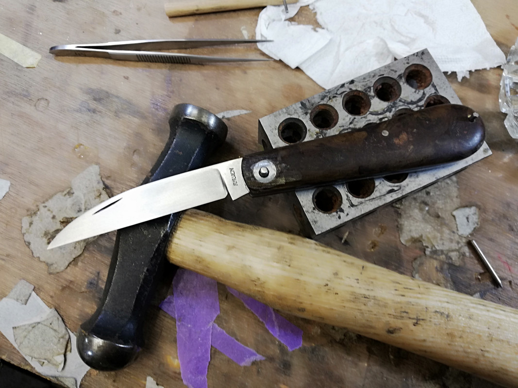

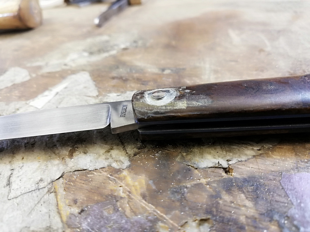

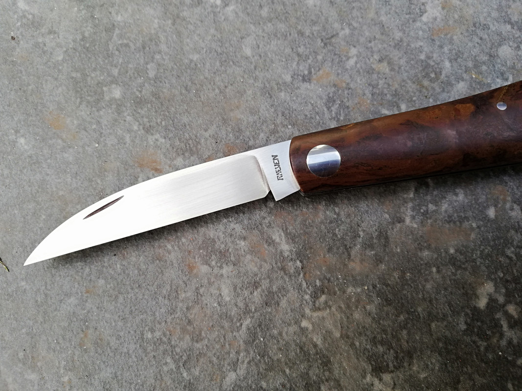

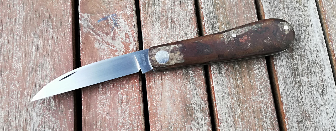

I've been waiting all christmass to be able to get in to the workshop and make some noise. Hammer-time!
This is slipjoint #11 and I have the idea that I'm getting somewhere with these pocketknives. First time making the pivot pin disappear on both sides!
The steel disk the pivot goes trough is 8mm, I think 6mm would have looked better.
This will be a late christmass prestent to myself.

I called it to soon, the pivot didn't disappear as I hoped. I've got a conical hand reamer on order for the next one.

Use CA glue to fill that gap , when you finish nothing would be visible . Just be patient , do it several times and be careful not to trap air inside , use the tip of needle .
carbon will reflect light through CA and the gap will not be noticed at all
You can also fill those voids in carbon in same way .You will not be able to see them under microscope after you finish :)
There is also black coloured, toughened CA glue, or you can dye your CA glue
Do test pieces first.
