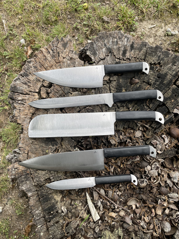

TheEdge, please do not take offense to this. When I first saw the picture, my immediate thought was that they were Pakistan blades. The beak and exposed tang at the heel is a very common feature on many of them, so it's something to think about design wise so your's don't get lumped into that category!!Here’s a kitchen knife set I finished up yesterday. They have carbon steel blades, G10 scales, and G10 pins.
It was a set designed to the customers specifications. Unfortunately, the pic he sent me was from a Pakistani set he found online. I mostly use .085 thick 1075 when I use carbon steel for kitchen knives. They are saber grinds, so I probably need to work on the grind a little more. ThanksTheEdge, please do not take offense to this. When I first saw the picture, my immediate thought was that they were Pakistan blades. The beak and exposed tang at the heel is a very common feature on many of them, so it's something to think about design wise so your's don't get lumped into that category!!
What steel are you using and what thickness? What is your grind type on these? I can't tell if it's a saber grind, or if that is a convexed area? You may want to try bringing that grind up a bit higher on the blade if it's a saber grind? Most of the profiles look good, but the 2nd from the top looks like a boning knife and most people prefer to have the tip lined up with the spine and not dropped down as much as yours shows. Your finishing on the blade looks smoother and cleaner than another set you posted not too long ago, so you are making good progress!
Thanks for the feedback! I’m always on the lookout for improvements, so please feel free to critique my work if something doesn’t look quite right.Ah, ok! Customers sometimes want strange stuff, so that's not your fault! LOL, I've had a few strange requests in my time!
