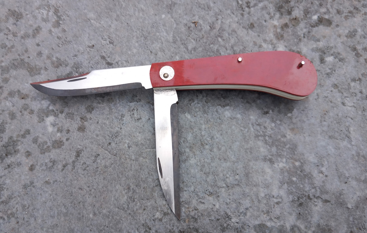

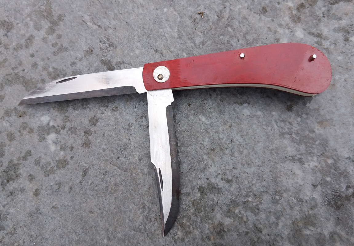

Tony Bose pattern and trying out some vintage phenol material.
Just enjoying the process :)
