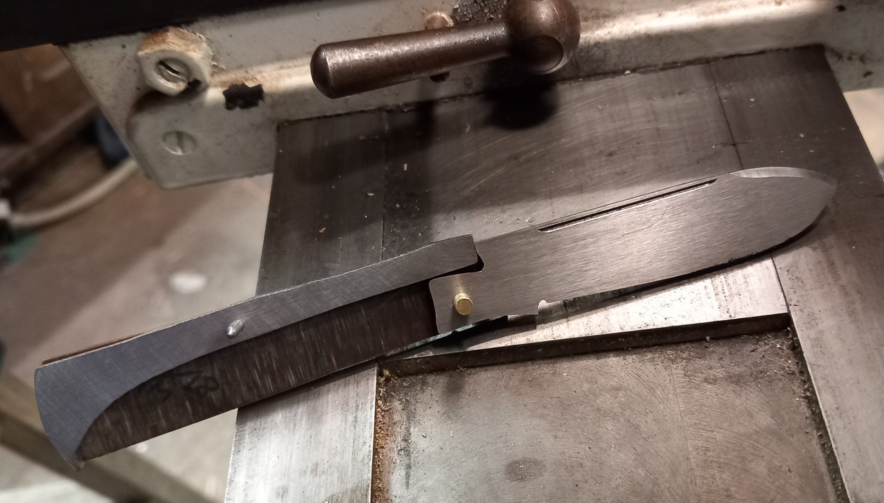

And I was having so much fun that I decided to cut a nail pull on both sides of this blade!
No I didn't, I was so exited that I didn't pay good attention, but I actualy think a dubble nail pull gives it a bit of an I-beam look and I'm keeping this one for myself, so it's OK.
