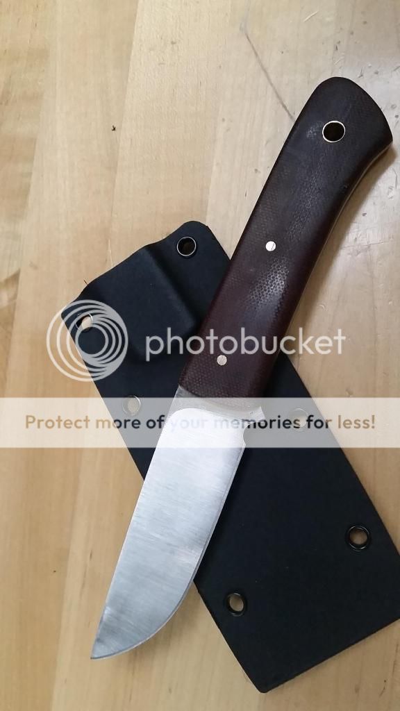

This is a prototype for a bushcraft-ish knife. It's pretty rough-looking because I didn't do to much finish work on it. Taking it into the Absaroka-Beartooth wilderness for some backcountry hunting and field testing.

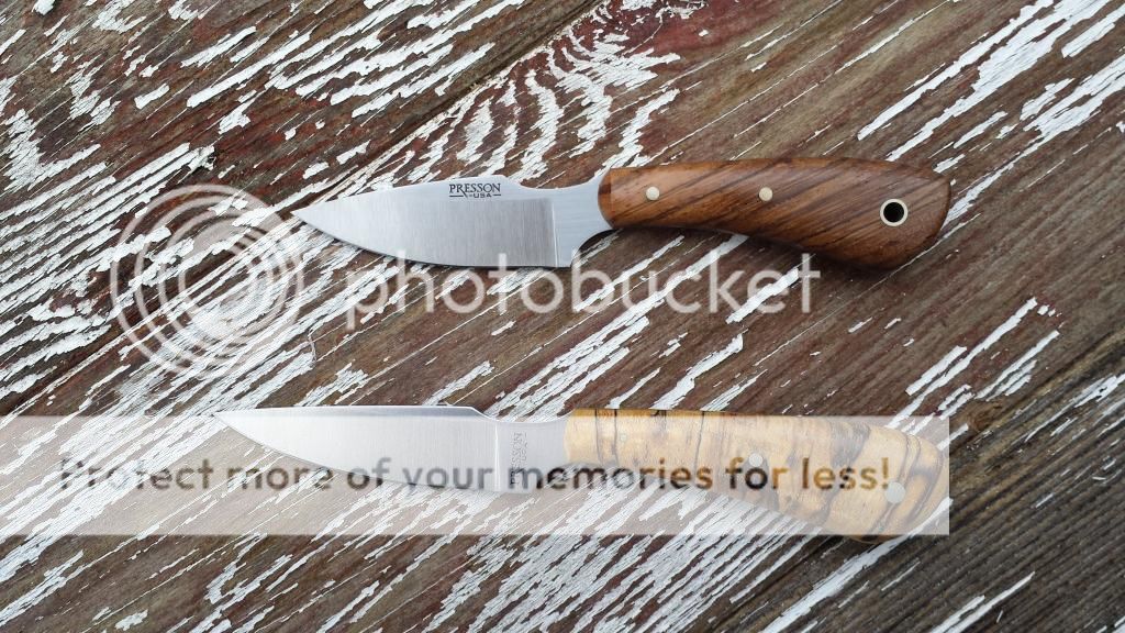

I'm currently working on a mirror-matching set of polished/forged fighters in Ebony and Thuya burl. The polished version has two-1/4" carbon fiber pins in the handle slabs. The forge-finish blade will have the reverse of this with Thuya burl bolsters(front and rear) with 1/8" carbon fiber pins and the handle slabs of Ebony.
-Peter

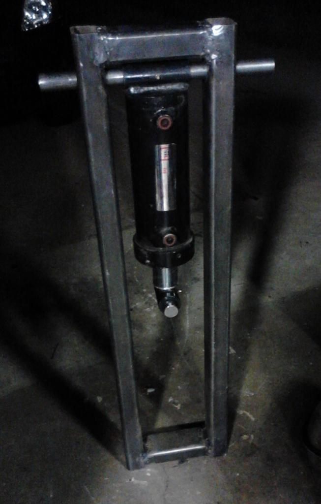

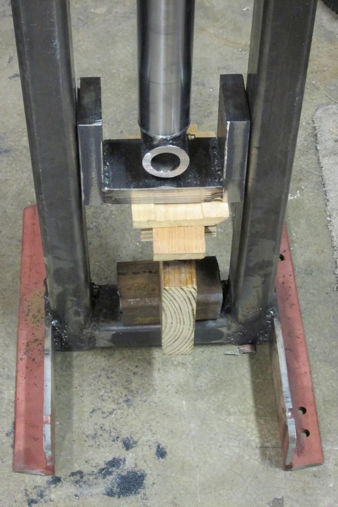

After a long period of collecting parts, I finally started building a hydraulic press this weekend. It's intended to be a small footprint tabletop unit. It will be about 13" wide and 42" tall. It will get some additional reinforcement, but here's the basic chassis...

Mr Crawford, are you using any plans to build your press. I am as well planning on building a bench top hydraulic press. Where did you find your materials, and what are your plans for a hydraulic system spec wise. I am very interested in your construction and am looking forward to the complete product.
Hi Gting,
The only plans I'm using are some drawings I did in MS Paint to try to anticipate the problem areas. I did read every thread on hydraulic presses I could find and then read that much again on log-splitter threads. Surplus Center (www.surpluscenter.com) is a great place to start shopping for hydraulics. The cylinder is a 4" bore with a 2.25" ram and 8" of stroke. It will be powered by a 7.5 hp electric motor coupled to a 6 gal/minute single speed vane pump (I wanted it fast & quiet). The valve is 3 position with spring return (no detent). Once the hydraulics were bought I found a steel yard with a good scrap pile. It was 40 miles away but worth the drive. The basic frame is rectangular tubing with 1/4" wall thickness and I'll add to it where needed. My cylinder has cross tubes so I use 1.25" 1018 steel rod to pin it in place. Hre's where I left off tonite. Feel free to email me if you have any questions.
