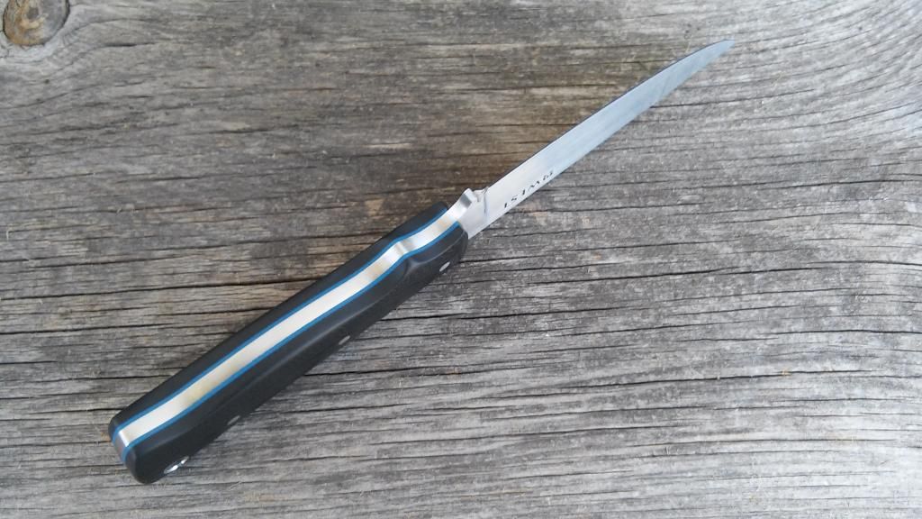

My second knife. O1 steel sanded to 800 grit, beech handle coated with linseed oil. All that it is left to do is to sharpen it.
^ super clean and functional, fantastic 2nd knife. :thumbup:

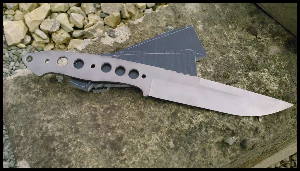

Just working on SK "Metro" made from Bohler M390PM steel, 4,3mm thick :)
Tommorow sending to HT :)

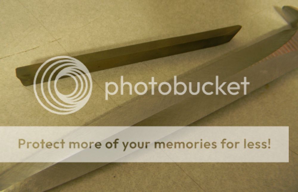

@Nathan : I know how it is, damn machining marks haha. Are you just using an oil stone by hand to remove them?
It's a stone, commonly referred to as an EDM stone (though they predate EDM). They're like an oil stone but softer. They're used for this same operation in molding making and other metal trades requiring finishing. You shape them with a file and use them in much the same way you might use a piece of sand paper wrapped around a stick. Sand paper dulls, these are self sharpening, so they're good for removing metal quickly and with control.
Cool, will have to check them out.
