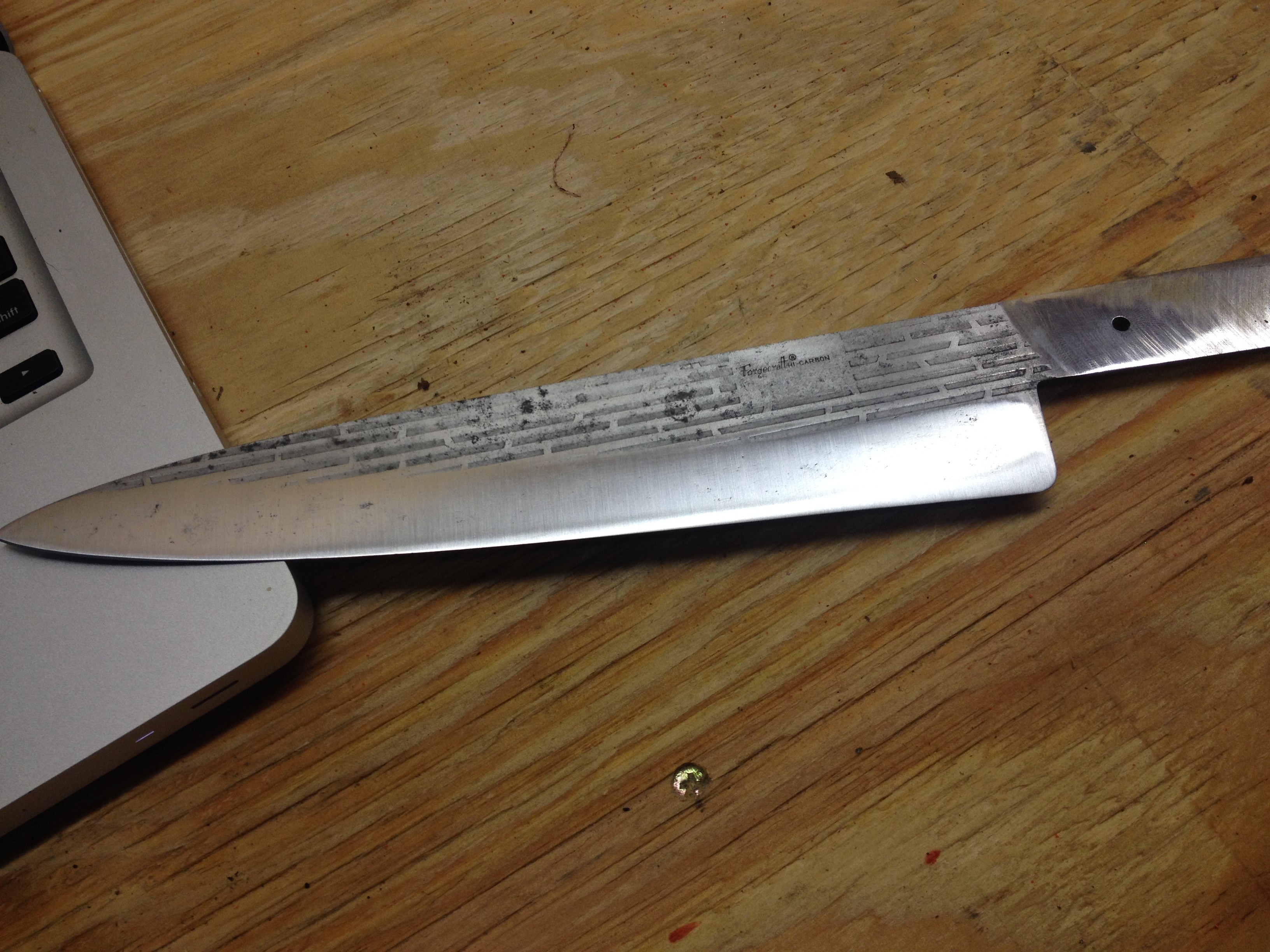

I finally had some time to work on my Forgecraft chef knife refurb project.
Here's the result finish of my first use of a scotch brite belt, I love it!
and… here is the handle glued up and ready to cure for 24 hours

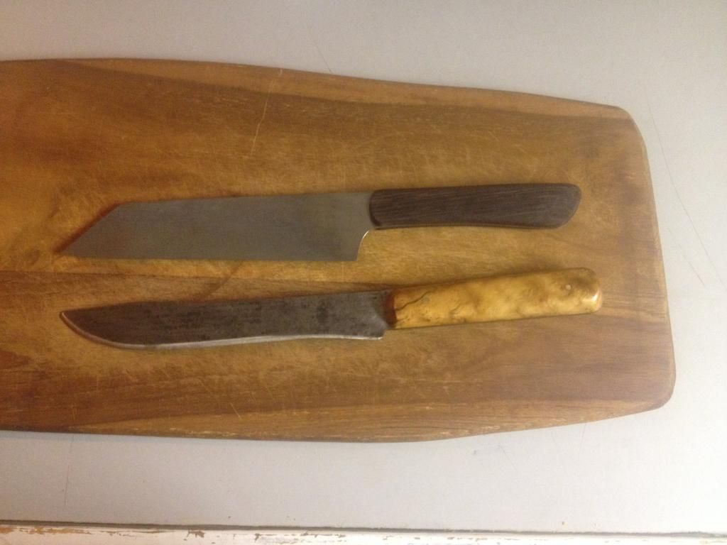

This is what needs to happens when a finished blade develops pitting under the protective painter's tape. This is a forged W2 blade that was built up with ebony, premium Thuya burl, and carbon fiber pins.
Never again will I tape a blade.
Bottom knife:
-Peter
Peter- Yep... been there, done that. :(
A quick wipe-down with a good oil, like Balistol or RemOil.... then wrap it up in the 'ol phonebook/catalog page with some of el cheap-O Harbor Freight electrical tape is the way to go.
It's slightly less convenient than directly applying painter's tape, but I have never gotten that pitting bullshit with the oil/paper wrap, but I got it many times with tape applied directly to the blade.
Sorry to see you had to go to that extreme, but I sure do know the feeling. It is a testament to your commitment to only send out work that has been done to the best of your abilities. In our throw away society, that is a concept that many folks simply cannot understand. Kudos my friend. :)
