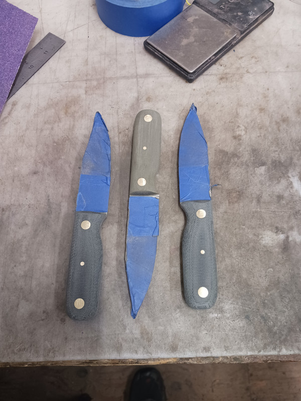

nice etch!Finally made a fishing blade, the Pike. 2mm convex RWL-34 at 63 Hrc, 124 mm blade. All micarta handle.
I hope you don't mind me saying but clocking the micarta pins (having the lines in the pin go butt to point) would have made a big difference imho
Thank you! Done with laser needless to saynice etch!

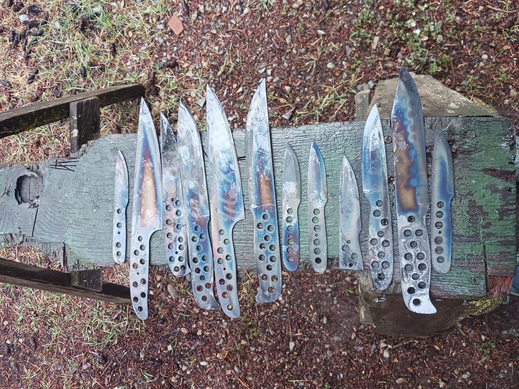

Heat treating on Thursday, tomorrow Corby and tubing holes and probably some select skeletonizing holes.Where are the pin holes in the tang? You are heat treating before those are drilled?
I miss the Taurus!

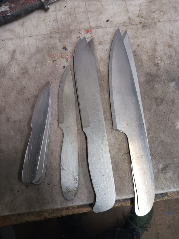

Well don't cut it all up some of us might want the whole sheet!Processing SOOO much G10 today! If you process sheet material on a regular basis, I can't recommend a good track saw enough! There are a couple of guided circular saw attachments that are nearly as convenient, but a dedicated track saw is hard to beat! Tomorrow I'll post the setup I use to churn out high volumes of 1.5" scales and 3" slabs.
I've never thought about a track saw that's a good idea.
