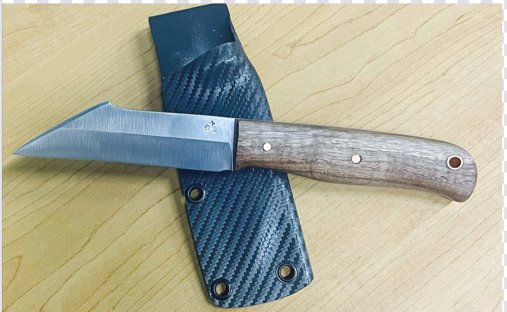

Finished and sharpened up an older blade. Proud of this one. AEB-L treated at 1950F for 15 minutes, -100F quench.
