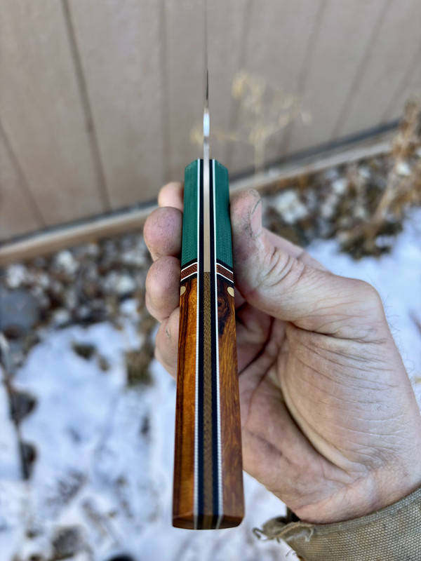

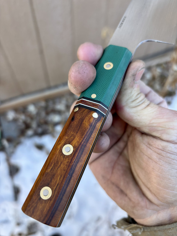

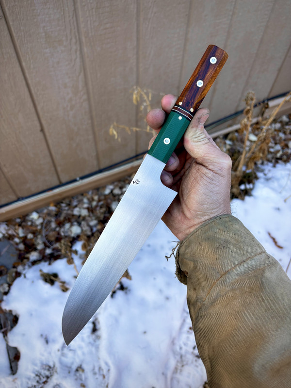

Chef's utility knife straight out of the tempering oven and off the grinder. I'm still pretty new to knife making, and I think this is my 12th knife overall, and my 3rd heat treating myself using a HotShot oven. I've been determined to free grind my bevels, even though I built a really nice bevel jig. These are by far the cleanest and thinnest bevels I've been able to achieve. For the finish I used all four Scotchbrite grits. 1084 and waiting on some Micarta for the scales
