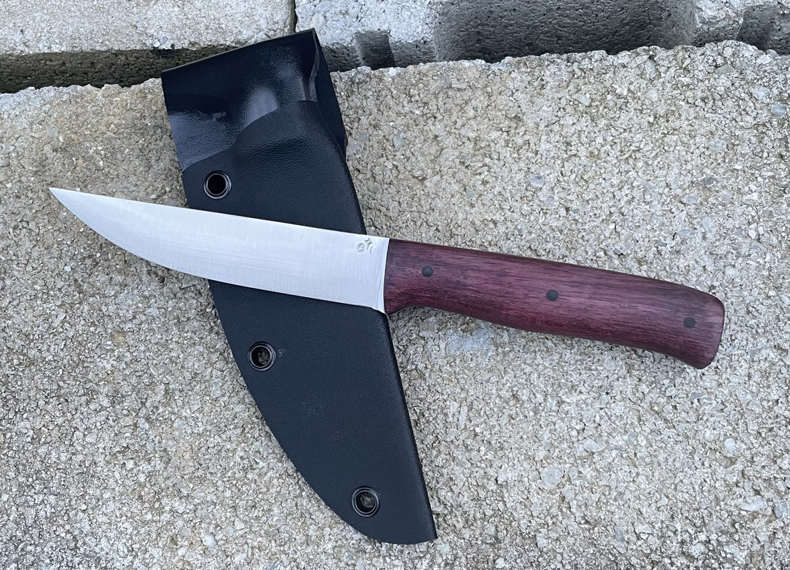

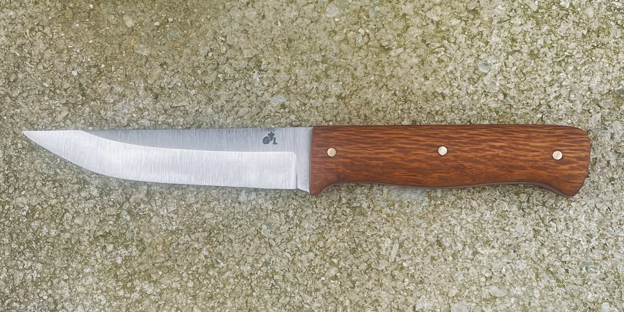

Wow, how was the flex and bowing when grinding? How is the flex in the blade now? I guess the wide blade and your ricasso/handle design help with it not being overly flexible.A self-imposed challenge: the longest knife I can fit in the longest diagonal of my HT oven not counting the handle, that's 410mm/16.1" in 1.6mm/ 1/16" or less thick steel. My previous attempt using 1mm/0.04" thickness failed, so I relaxed the challenge a little.
Used Sandvik 1095 in 1.6mm thickness, and ceramic blanket to close the ovens front with enough space to leave the handle out, after quench in preheated oil it went straight to my water-cooled press until warm, then directly to the tempering oven.
Straight as an arrow!
Handle in Guayubira wood, used half a cow for the sheath, comparison photo shows a 300mm/12" OAL kitchen knife.
End size 520mm / 20.5" OAL
Pablo
PS: please don't mock the anti-safety device LMAO
It flexes but the strategy is to go by sections and blend them between passes, it can be done.Wow, how was the flex and bowing when grinding? How is the flex in the blade now? I guess the wide blade and your ricasso/handle design help with it not being overly flexible.
