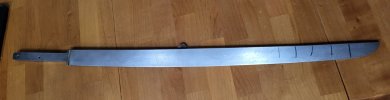

Must be "the season" this is my 4th sword like object. Stock removal clayed W2, tip had a slight bend, hence all of the straightening hammer marks. Profile started out at 2pounds 10oz it was down to 1 pound 7 ounces before heat treat. OAL is 27.5" with about 22.5" cutting length. I cut the blank with excess sori to account for quenching in Parks50 and it gave me a nice negative sori when it "nose dived" in quench. Going with a blued mild steel tsuba, natural jute micarta handle and probably a pair of stainless take down pins (mekugi) if I can fit it tight enough.
