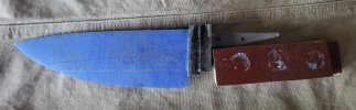

Bottom knife will be my new vacation cooking knife 6" Chef in Nitro-V spine is around .07" and the handle will be a hidden tang in black and natural canvas micarta.magnacut filet knives41326.jpgnitroV minichef wip.jpg
