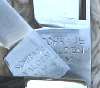

Schrade Walden was the company name after Albert Baer bought the company from the Schrade family in 1946. The name was kept when the company moved to Ellenville in 1958. It was changed several times over the years, first in 1973 when the name "Walden" was dropped. Eventually it became Imperial Schrade, but the tangstamps usually, after 1973. were simply SCHRADE.
Here are a few examples. Remember that they are just a few and others exist that vary from these.
Many, many knives were made between 1946 and 1973 that don't have the company stamp on them at all. Some have merchant's marks like "Craftsman", "Powr-Craft" etc.
So a true Walden made Schrade knife will have Walden N.Y. on the blade correct ??
A few of the very early Schrade Walden knives might have only Schrade / Walden / N. Y. These often had all blades stamped, not only the master blade. For the most part of the 1946 to 1973, they added U.S.A to the stamp, and only stamped the master.

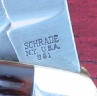

Schrade also has some Schrade NY USA stamps right after 1973, when they dropped the Walden from stamps. Not all patterns used this stamping.
Early Schrade Walden N.Y. (1946 to ?)
Early Schrade N.Y> (Post Walden 1973 to ?)
