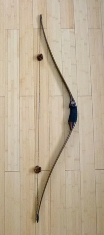

Very cool, J! That bow has some serious recurve to it!! Beautifully built riser as well.
Sorry Bruce I just saw this
This bow is crazy
As the tips uncurl you get a perceived letoff
Nothing compound like just a smooth pull that gains weight quickly and than lets up
Much more than the Hex 6
Speed wise pound for pound it is the fastest recurve I have ever seen
I have played with a lot of very high end bows from Silvertips to hopped up carbon foam limbs on ILF risers and while I love them all this thing is freakin awesome

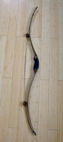

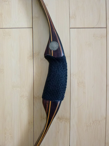

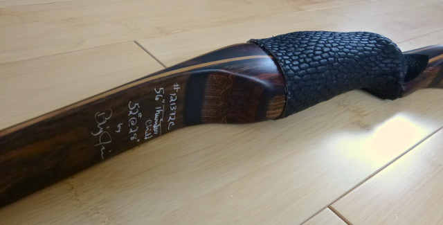

And since we're showing off new bows, here is a Big Jim's Thunderchild that I recently picked up. I'm really loving this bow, and it's been hard for me to shoot anything else since.
56" AMO
#52 @ 28"
Bocote veneers
Carbon/bamboo cores
Rosewood riser
WOOF! I can see why you can't put that thing down.:thumbup:

Thanks. With the carbon/bamboo limb cores and radical r/d design, it's a fast little bow, and I'm not exactly shooting a light arrow (620 gr.). It's also surprisingly stable for such a light bow. I shot it the other day with a bow quiver and without, and it didn't make any difference at all.
