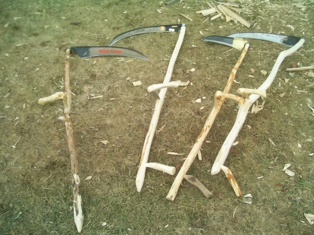

Spent some time cutting "a few" staves and handles for wildwood snaths this afternoon. Cut more than I could carry back so I will have to take another trip or two or three down the road. Already crowded shop is more crowded. These are a few I could remember stowing away in easy to reach places.

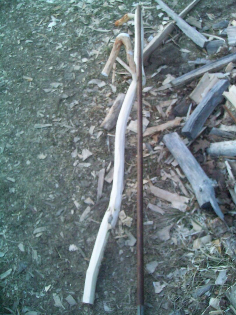

Not sure what I saw in the peeled one with all the curves. looking at it just right there is something there though, I think.
Started itching to work on that weird one after posting that photo. Twas a brain puzzle to orient. Nice offset to it though.
Just a few hundred more, and your shop will look like Peter Vido's! (My brother used to have a hard time working in the woods with him because Peter would always be rummaging through the brush pile dragging out snath material.).
The curvy snath looks interesting, to say the least. It does have a good offset, so the grip angles will be important. A lower grip without such a steep angle might feel better... but once you have some blades to play around with it will be easier to feel the angles.
I also like the look of the (beech?) snath to it's left in the previous photo.

I still haven't glued a single handle yet, want to try as many as I can before I do that (not in use I guess, just hefting and holding). The steep ones are not as nice because they seem to want to drop out of grip all the time. The other snath is Maple, but it was a dead branch and has some slight spalting on one end. I think it will have to take a blade with a steeper tang because of the curve.

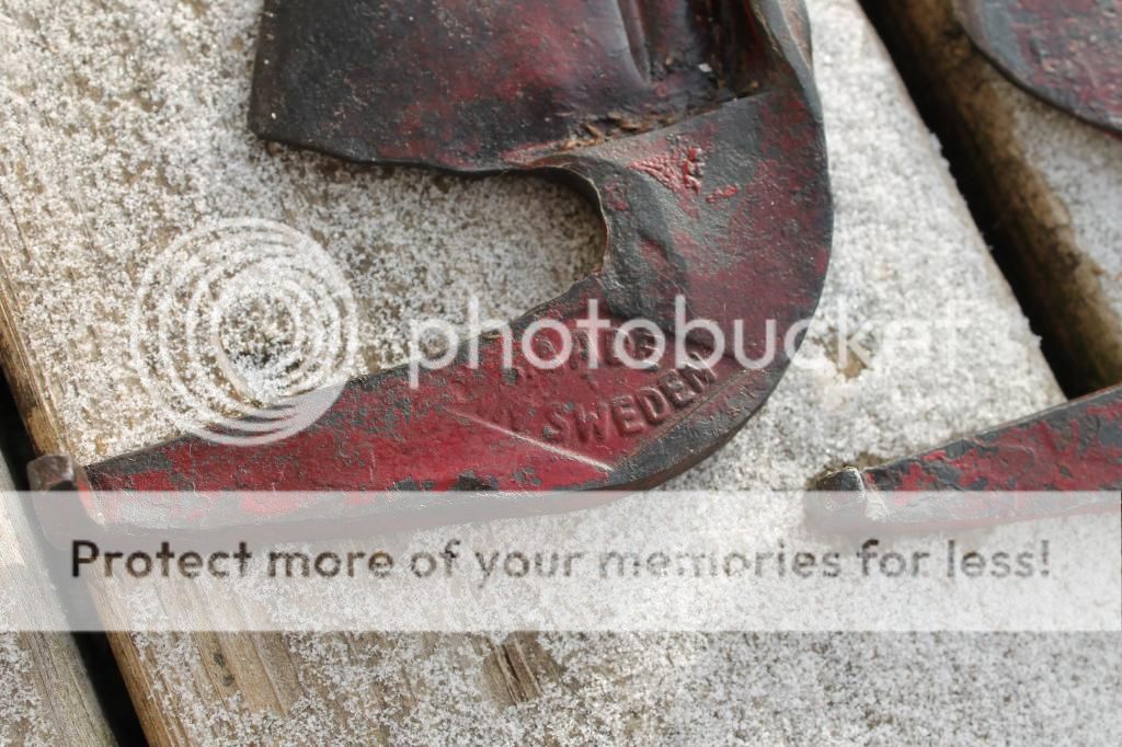

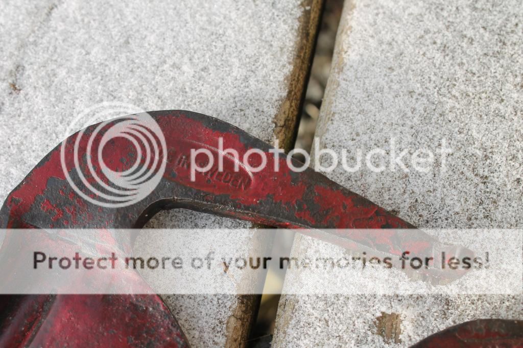

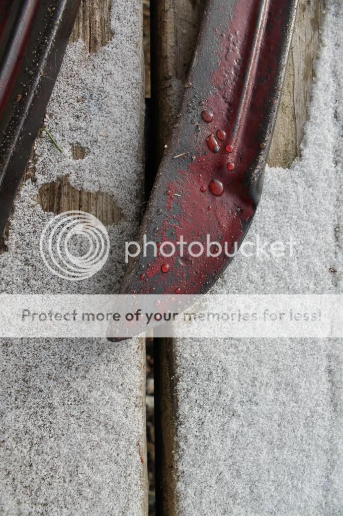

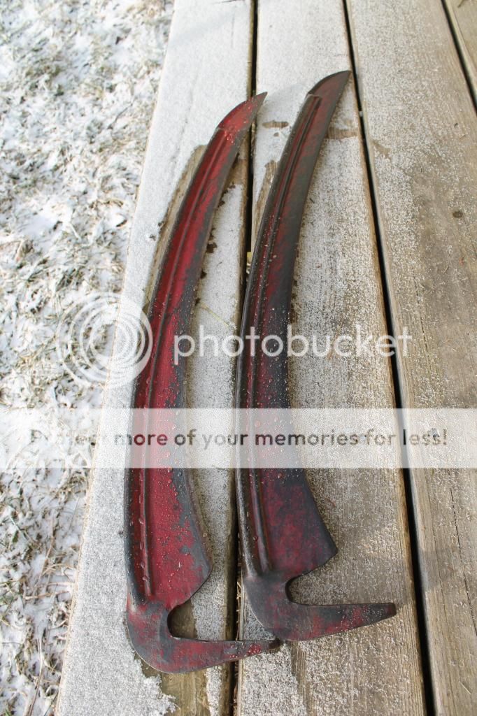

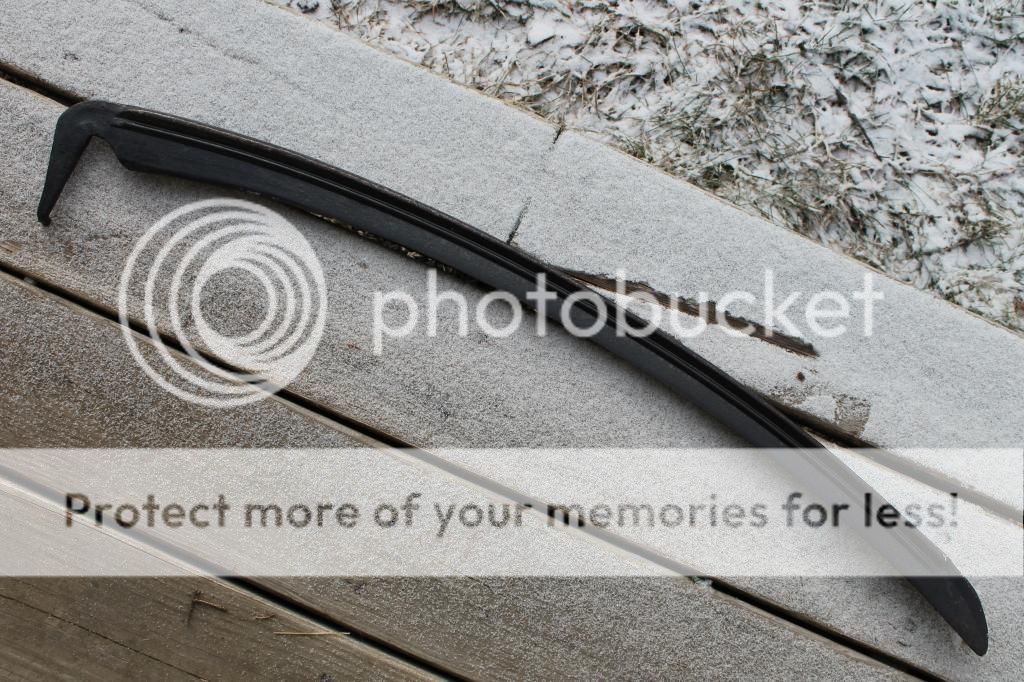

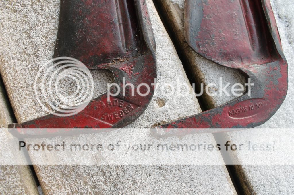

I scored a couple of very nice Dutch heel weed blades that were made in Sweden. They very strongly resemble the TrueTemper weed blade of mine only more cleanly executed. No specific maker's mark on them, and the blades both have different "Made in Sweden" stamps on them in spite of being fairly obviously from the same maker. I also found an older D&B snath of good strong curvature to send to the steam bender I contacted for use as a template so they can see the kind of curves to set. It came with a nice North Wayne Tool Co. (Little Giant) grass blade on it that looks almost identical to my Rixford. :D:thumbup:
Did a little cleanup work on the Little Giant grass blade. It had a lot of old rust and crud on it and even though it has a little light pitting it's in very good shape. A fresh coat of Ballistol and it was ready for its photo-shoot! :D

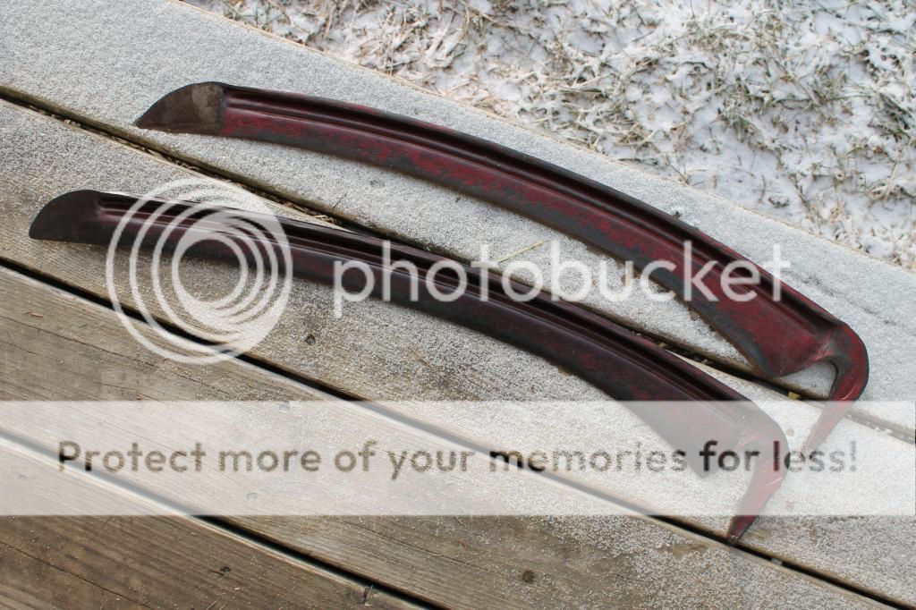

Here are those lovely Swedish weed blades. Nice long ones!
