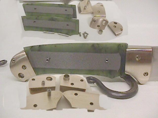

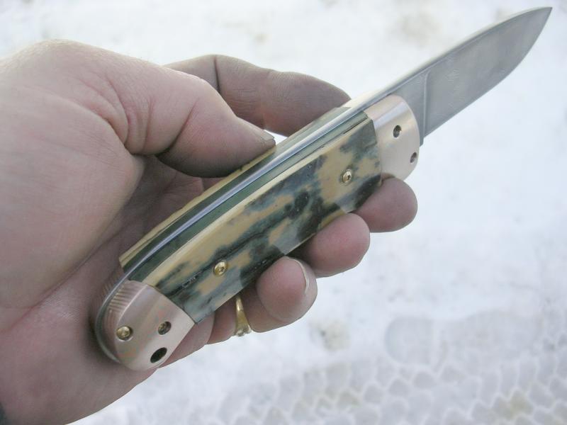

OK update.. guys
I took some time today and got most of my end done.
the ivory is drilled and counter bored for the alignment/hold down pins.
and the pins are fitted..
the two center pins are at different lengths because of the tapered tang and thinness of the ivory ( because of the thickness of the jade) the counter bore into the Ivory is .050
at a later date I can counter sink the bark side of the ivory for the Gold plated screws if anyone thinks it will look better.. but the more it's bored out the less the head of the screws have to hold down on, we have some to work with.
DAN K do you want to do the assembly paper on it?
there should be one made, to properly take down and put this back together..you never know who will end up with it.
this thing is pretty close fitting so some pusher screws will help in removing the pins until they loosen up some from take down wear..
I'll do some rounding of the spine and it needs a little work at the finger guard
basically a transition point for the relief of the bolsters and jade..

on the contrary, the plated screws fit better, the heads are a few thousands smaller than the other temporary screws. they fix the counter sunk holes better.
what I'm saying
ivory left,the material left for the screws to hold down on
we have the thickness of the ivory.
less the .050 bore for the pins to align in, on the back side..
if I counter bore to sink the screw heads like I did on the bolsters it will leave that much less meat to hold on to.
I think I will do it anyway just a little to make it look better.
I'll send the blank back to you also,, I think you'll need it to finish up the profile of the bolsters . ivory and jade.
also if you round over the joints just a tad it will help if when the ivory moves..

Roger, AOK on the contouring of the bolsters
but I'm not sure what you mean, dove tail the face of the Bolsters?
contouring a bit should add a lot to it, matching the front to the back a little
better.
I can knock a little off from them.
yes some glue won't hurt it for sure..you'll see a place on the upper right front that could use some filling also..
ok on sending the blank back, I'll ship the reg screws too so the gold ones will see less wear and tear while you work on it
with two longer screws to help to take it apart as push rods
you just need to screw them in some first so the threads won't get damaged.
I'm sure you know this anyway, but I mention it for others looking..
I'll chamfer the screw head bores also,
once you get to finishing the bolsters up a good buff in the holes should round them out nicely
or if you have a better way,,,,,,,,,,,, go for it.. :)

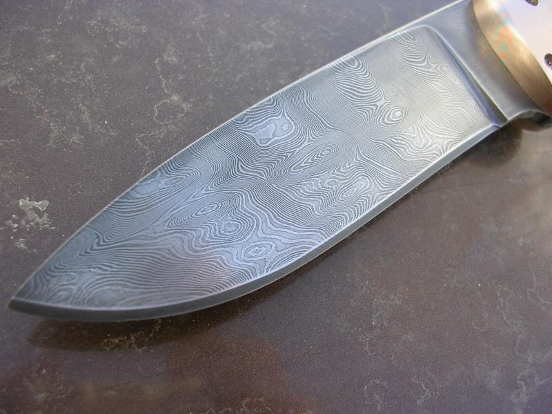

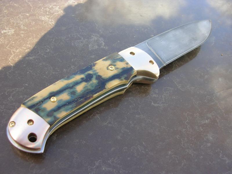

I didn't etch it deep at all, mostly to darken it. man the protruding tapered spine looks nice this way darkened and rounded. :)
with a deep etch it will be a sweet touch..this will be busy but not if to know what I mean..
To who gets to etch this (I can't remember who?) I'm thinking a resist added to where the handle material sets would be good untill the rest is almost done..
then a light over all etch for looks under the handle,
we need to make sure NO etching happens inside the holes we don't what the holes to enlarge at all..
let me know what you all think? changes ? OK ? not ? ideas ? :)

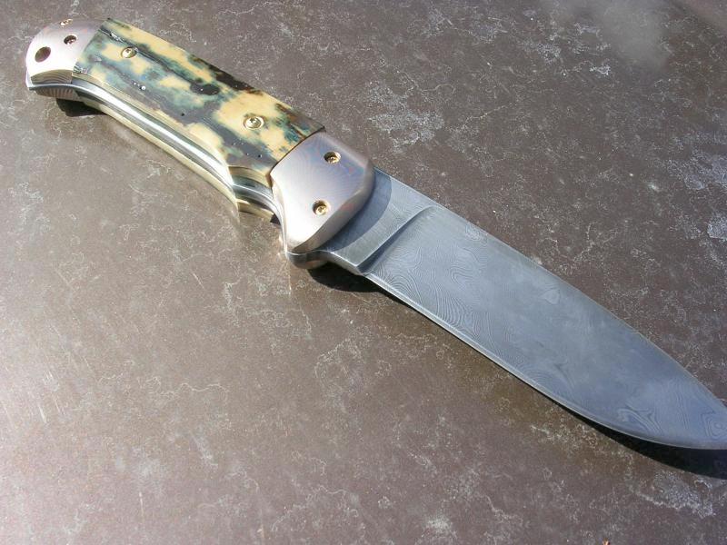

ok tell me what you think?
it's ready for you Roger
in case you guy lost this
http://www.knivesby.com/collaboration.html :)

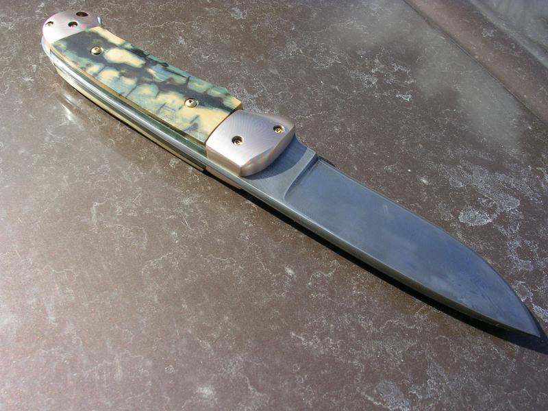

mounted on the blank before the jade was taken down by Roger
It looks awesome so far! No visible gaps. Cool damascus pattern too. You may want to counter bore the scales deep enough to bury the screw heads. When does it go to Walla Walla?

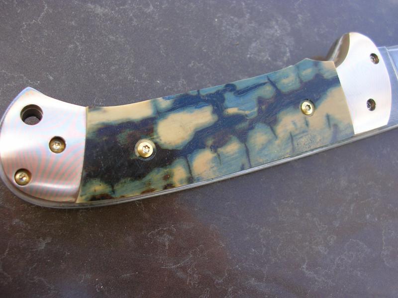

Bruce they are couter bored now but very little as mentioned
the back side is also couter bored at .050 for the pins so because of the thin ivory , it's even thinner under the heads now..they can go deeper
at any time, but I'd like to see this compleated first then if everyone wants it done deeper AOK with :)
there is a small gap at one of the dove tailed ends as Roger mentioned
the only way ( keeping what we have ) to fix it would be to take the flat
back side of the dove tailed bolster down, efetivly closing the gap..I'll let roger make the call on that

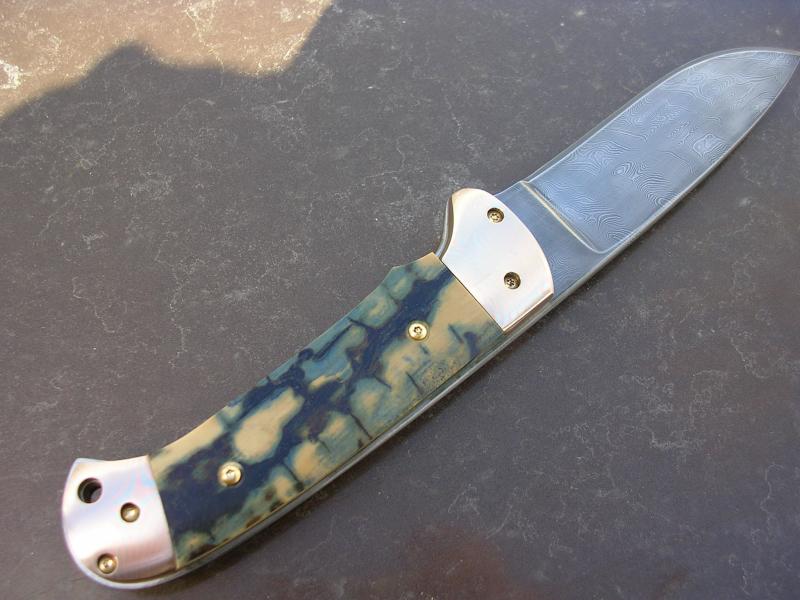

Roder the package left yesterday by USPS. you should have it monday..
SUPER!! Great photography. Someone correct me but I think from me it goes to Steve and from Steve to Bruce(?).
RL
RL
don't know
yes to start with but there isn't much else Steve can do to it I don't think? other than the only thing I can think of is up under the finger cutout
there are a few grinding marks,, I was going to remove those but forgot to.. I may have gotten carried away finishing up the outer profile :(
sorry I couldn't help myself.. :( look it over and make that call when you see it I guess..
