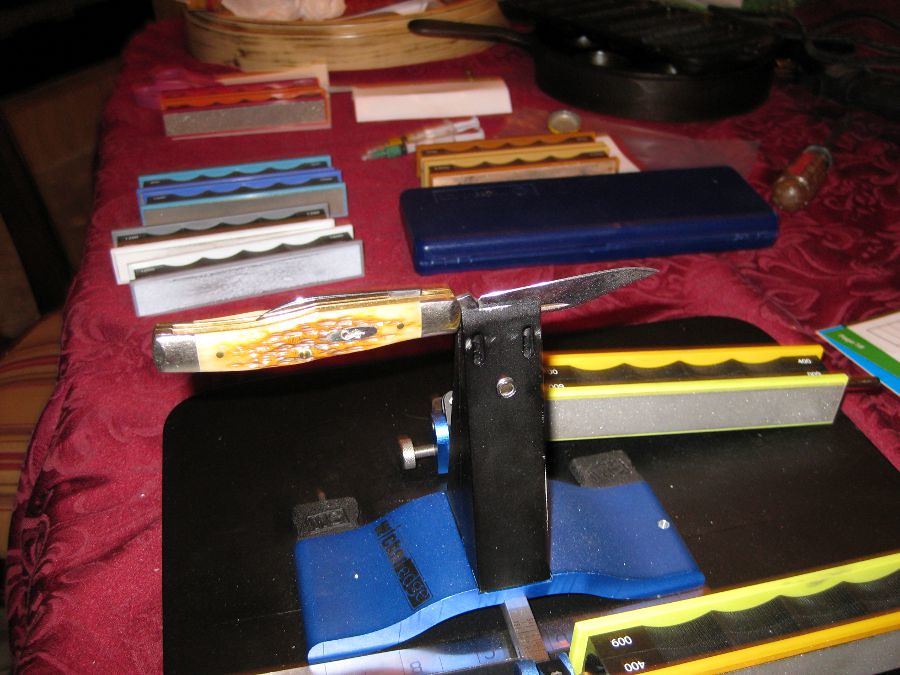

Im typing this on my phone. I have had blade shapes that have presented moderate challenge to clamping.
Keeping the blade vertically perpendicular was the challenge. It is possible by holding the knife in proper
Attitude while snugging the top screw and then tightening the bottom screw. Keep the gaps to the left and right
Between blade and vise jaw even. Record your settings. If blade shape does not allow for contact with both depth
Rods. Contact one and keep the blade edge parallel to the plane of travel for sharpening. If you follow these simple
Steps your positioning should be right and repeatable.
I think I'm starting to get the hang of using the WEP. Still can't sharpen by feel or sound, but increasing the number of passes as you move up in grits seems to work.
I think I've figured out a way to sharpen my Case Texas Jack without scratching my WEP too much more. ;)
That's just about how I'd grab it too. You could push it up a little higher so that the thumb groove is aligned with the top of the clamp so it's easily repeatable and you can get an even lower angle, possibly 17 degrees.
Thanks for the validation, Clay. Good suggestion on using the nail knick to gage the location.

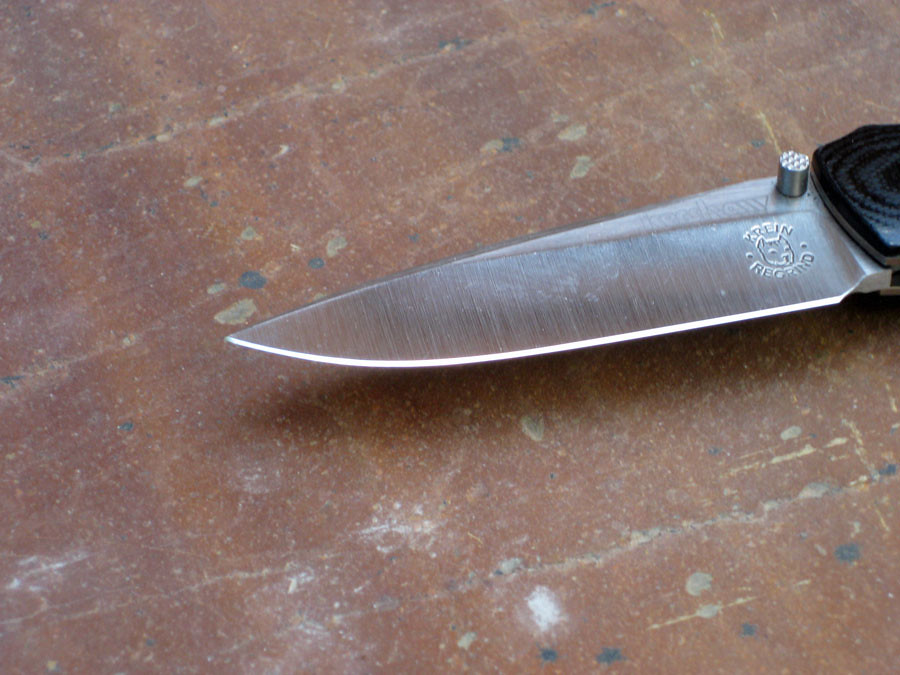

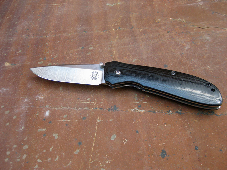

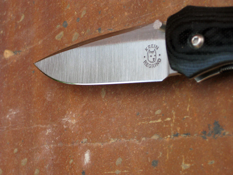

Thanks Clay...Its look like you did a wonderful job on my Benchmade 635 (S30V) and Sebenza 21 (S35VN), Hope you can send Me the video soon. I will post some picture when I get my knife back.

My last upolad attempt failed so I'm uploading it again now. YouTube says there is one more hour to go. As soon as it's ready, I'll send the link. I can't wait to hear how you like the knives.
