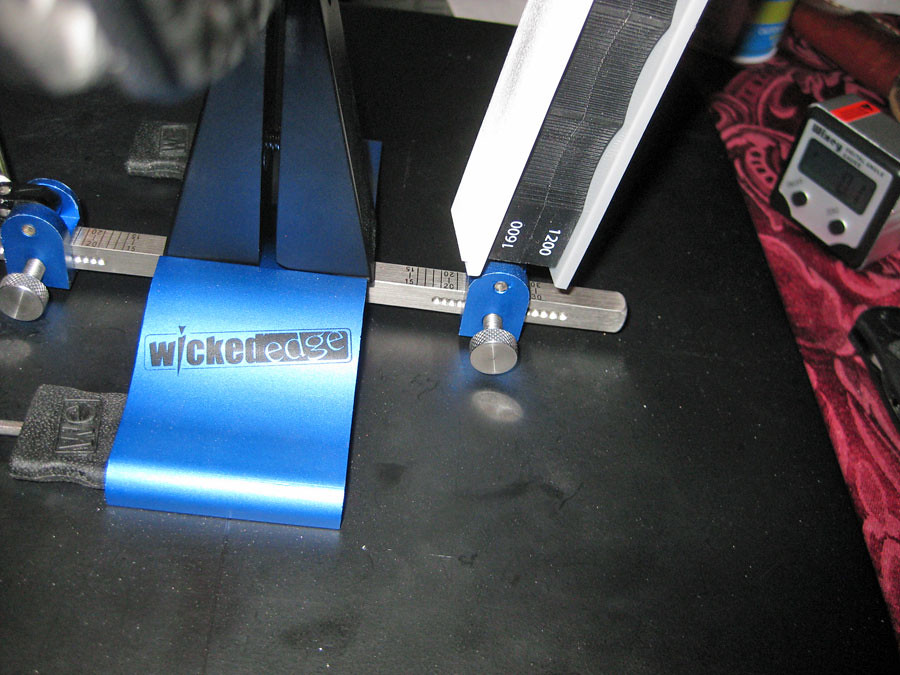

what is this angle cube ? i tried to search the thread but no answer. can someone elaborate please ?
thanks.
thanks.
It is a digital angle finder with magnetic sides. If you place your paddle on the WEPS on the blade after you have set the angles, you can place the angle finder on the paddle and read the exact angle. If there are differences in angles between the two sides, it is easy to adjust things so that each side matches pretty precisely. If one is going to use the Chosera stones, the angle cube will be necessary to set angles as each set of Choseras will wear differently.

One thing to take into consideration first is, if your work surface that you're setting the WE on isn't level, your angles won't match, even if they're, in fact, the same. Always check to see what angle your work surface (sharpening base) is so you can figure out if your rod angles are correct. For instance if your work surface is 1 degree to the left, and both rods are exactly 20 degrees to your edge, one side will read 19 and the other will read 21, which could lead you to believe your rods are set improperly when in fact they're just right. Gets more complicated if your work surface isn't an even angle... ie 1.7 degrees or 2.1 degrees, etc, because then your rod angles will show funky angles and make the math more complicated to figure if they're correct. Hope that makes sense, but it's something I've found to be true when working with my WE on my kitchen table and using my tilt meter on my iPod touch to read my stone angles. Best option is just make sure your work surface is perfectly level, at least from left to right.

The nice thing about this cube is that it can be calibrated to 0 degrees for whatever surface you are working on. When I am ready to measure the angles of the paddles I turn on the cube, place it on the base of the WEPS , press and hold the right hand button until it jumps to 0.00 and then it is calibrated for that surface. Now it will correctly read the angle of the paddle as it rests on the apex of the knife's edge inserted in the vise.

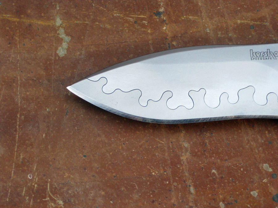

I've sharpened 8 knives so far and I think I'm starting to get the hang of using the WEP. So far the best results have been on my G10 Tyrade. The D2 has taken the best polish so far.
You can still see scratches, but its getting close to mirror-like.
That edge is looking great. Your stones are still breaking in so you're seeing more scratching. The more you use your stones, the more they'll make your edges shine.

That bevel size and consistency looks outstanding. As Clay said, the polish will come. The part that came as a result of your technique and the WEPS is the even consistent bevel.

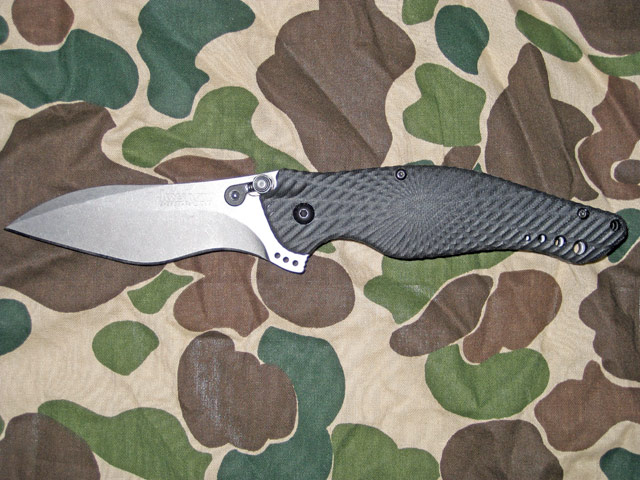

That is how my Acies looks now, wasn't close when it came new.

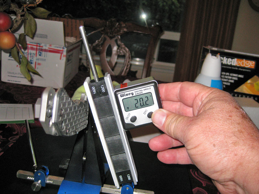

Thought I'd share my latest addition. A digital angle gage. I mounted my 0551 in the top position and set the angle on the WEP to 22 deg. and sharpened it last nite. Checked the actual angle today.
Putting the knife in the bottom position and the gage reads 21.7 deg. (Sorry, no pic, maybe later.)
Looks like the scale is pretty accurate if you put the knife in the correct position depending on blade width.
