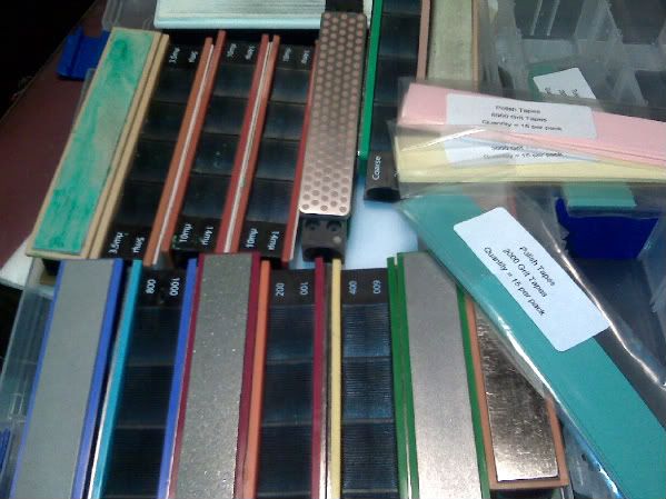

Of course you can go all OCD..........:o
Yes, I am sick. No, I don't need help. ;)
Thanks SV. I've been known to be a little OCD myself. But you've got a pretty good head start on me with that set-up. Very nice!
I think it should be a given that anyone that buys a WE or Edge Pro or has a big collection is just a touch ocd :) Do you use the tapes with the strops? Before or after? Is that a dmt stone turned face up?
i use the tapes and then spray the strops with wd40 , this seems to keep from damaging the strops, litely stroking the strops , use your sense of feel . Wow , beautiful mirror edge ! Patience and your sense of feel is the key . Ron.

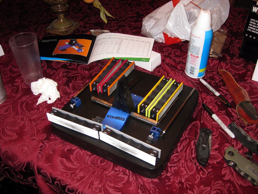

One other thing I wanted to mention - I found that my paddles were getting too scattered. Went to the store and bought some plastic boxes that are used for storing art supplies. They fit the paddles very well, they seal up tight, keep the strops separated so they reduce cross-contamination - and they stack up nicely.
Highly recommended for OCD-afflicted sharpeners like us.
