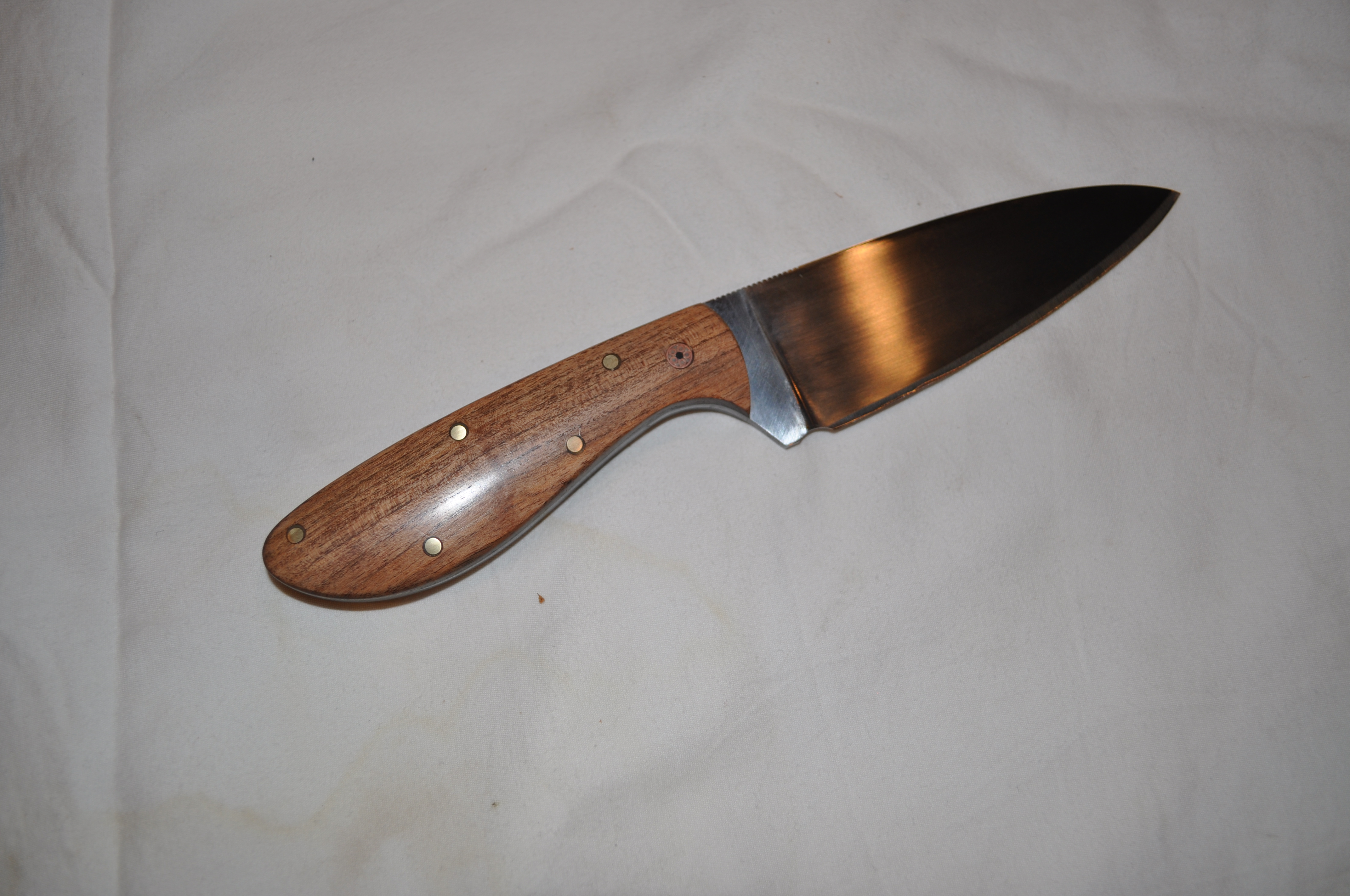

After 2 years and 50 knives, I would like to enter the Winter KITH.
I will be making a 5 3/4" Hunter/Skinner 1084 Aldo
Handle will be stabilized figured walnut with SS guard and spacers
[/URL][/IMG]
I hope this will qualify for this event.
Thanks,
Troy
Troy where did you get the walnut? It's going to go really well with your blade. I look forward to seeing it completed.
Thank you Beanman13 for your nice comments. That is Indiana Walnut that was cut and given to Purdue University. I am doing a research project paper with the
professors of Wood Science on stabilizing. For helping them with the research, they give me A LOT of wood for stabilizing. I have probably 400lb of walnut, cherry,
oak, and maple sitting in my garage. We have stabilized over 100 blocks and scales to this point with great success. Looking forward to seeing this one turn out.
Troy
