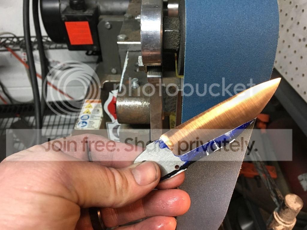

Yeah soon as I posted that I realized I forgot to drill them. [emoji53]
Ive got some good bits I think I can get it drilled.
If you have trouble with your drill bits here is something I did recently when I ran into the same thing. Take a kitchen towel and get it wet, throw it in the freezer for about 10 min so it's very cold but not frozen solid. Wrap the towel around your blade, then heat your drill spots up with a propane torch. Quickly drill them and you should be good, that should take the hardness out of the tang.

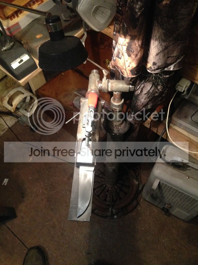

Looking good Warren. Getting some more done on mine as well. Got one side of the blade almost hand sanded and the other half way till I slipped and almost cut myself. I dropped back and made a longer bottom plate for my knife vise that will extend out to protect my hands from the blade. Just waiting on the epoxy to dry attaching a layer of rubber on the 3/8" flat bar. So putting safety first tonight. Got enough scars on my fingers already not looking to get any more if I can help it.
Much better. No worries on bloody fingers now. Making some more progress tonight about ready to start working up the grits. Just a couple more spots right by the plunges to work out with the 220 from the belts grinder.

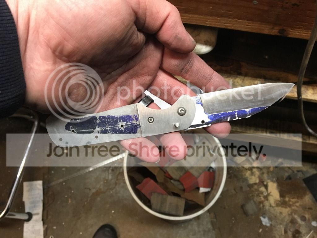

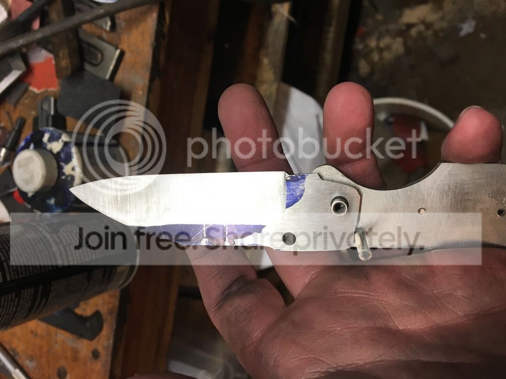

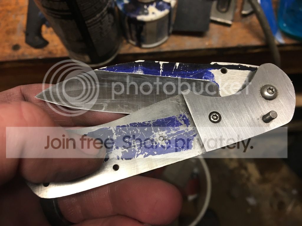

The blade is cpm-154cm from Aldo, heat treated by Peter's. 416 bolsters, backspacer is undecided so far.

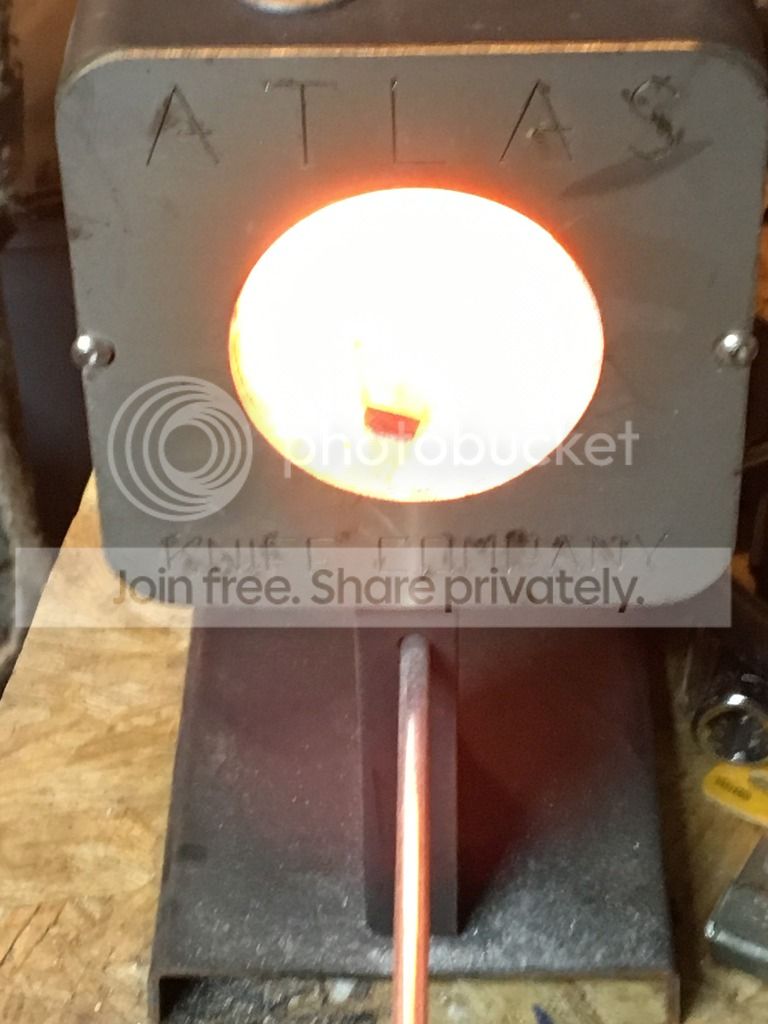

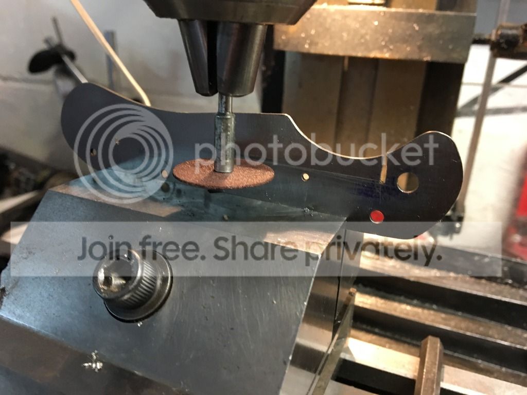

I've had a few hiccups with a backspacer of all things. I originally tried corian, it was too fragile so now I'm trying some Damascus I bought. Apparently it was forge welded with carbide and diamonds because it took me a while to cut it out with a dremel. It just laughed at the saw. It was the first piece I've ever bought so I don't know if it usually comes annealed. I tried to anneal it in my forge, but anyway here's where I'm at.
Here I am trying to anneal the backspacer
