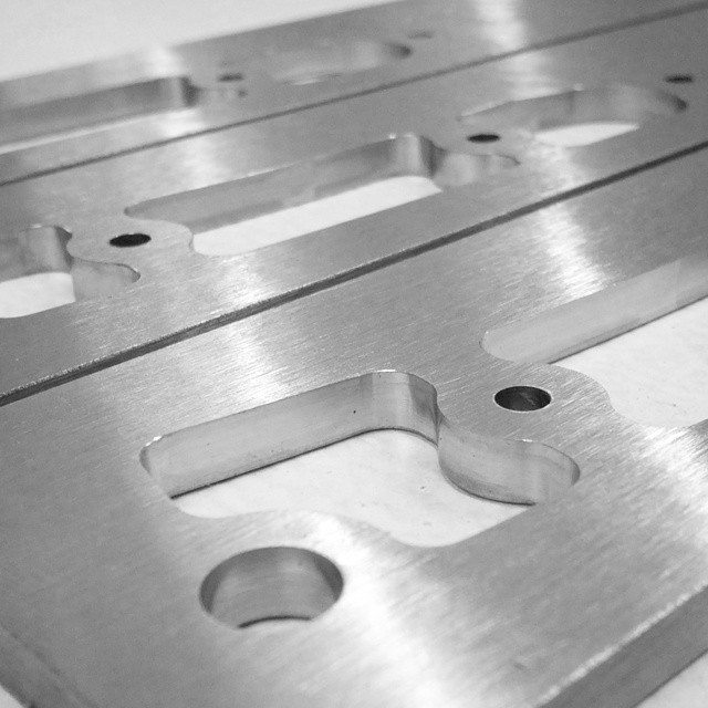

First step was to redo the toolpath for cutting the interior features of the tang. The pin holes are now drilled and then reamed to 0.1235" so I can get a much closer fit with my handle pins and help make sure my scales line up perfectly. I'm also now deburring the front and back of the part all on the machine! The tool that reaches through the pin holes to deburr the backside of the holes is only 0.098" in diameter! Seems to be working very well so far, the tangs come off the machine looking like this:

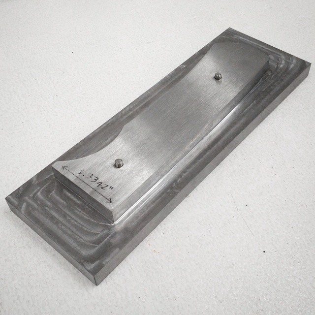

One thing that I'm focusing on is getting my tang size and position relative to my handle scale outline as close as possible. With our fingers we can feel a mismatch as small as 0.0005" (half a thousandth!) so the parts need to be exactly on size, and the pin holes need to be in exactly the right locations.
To help verify my tangs and scales in a quick and easy qualitative fashion I made a 'master' of the Resolute MKIII handle. I spent a bunch of time dialling it in to exactly the right size within 0.0001" so that I can use it to compare against the parts I make:
Because it has locating pins on it I can drop a tang or a handle scale on top and then very quickly feel with my fingertips whether it's undersize or oversize and also verify the position of the pin holes... This is not the sort of thing that would fly in an aerospace machine shop, but I think it will work very well for what I'm doing!

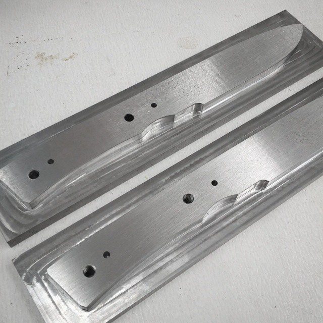

I also needed to make a new version of my second operation fixture for machining the periphery of the blade blanks:
These were designed with cutaway areas at the butt and at the choil so that I can get underneath the blank to cut the window-breaker chamfers and a chamfer just behind the choil. The position of the top left corner of these fixtures in relation to the pins is absolutely critical on this fixture as it defines how closely the blade outline will be matched up with the pin holes. The two you see in the photo were both rejects unfortunately, I got it right the third time though!
In the future I would like to develop a fixture that lets me machine the periphery and the pin holes in the same setup, that way I eliminate a step that introduces error!

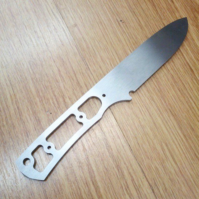

All of that work led to this:
This is a blade that's exactly on size, deburred front and back and already has the windowbreaker cut. Total machine time for this blank was a little under 11 minutes!
I need to work out a better way of hanging onto the blade while machining the periphery though, at the moment the stock near the tip is chattering and totally killing my tool life. I'm trying to find a source 'downcut' endmills so I can push the part down onto the fixture while cutting instead of pulling it up, I think that should solve the majority of the issue. I'm also contemplating building a small vacuum clamp into the fixture underneath the blade, those two things combined should hopefully let me run my tools a lot harder while also hugely increasing tool life!

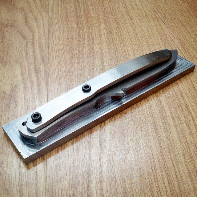

Ian, I took your advice mate! Made a new clamping caul for the fixture today:
I bent the spring 'finger' about 0.4" or so, then hardened it to about 55HRC. It exerts a LOT more force than the previous clamp did. With the old clamp if I pried underneath the stock with a screwdriver it was very easy to move it... Not so much with the new one! You have to really crank on it to get it to move! Thanks for the good idea!
Probably the weakest point now is halfway in between the point where the finger makes contact and the frontmost bolt. We'll see how it works out tomorrow morning!

Aaron, make two fingers. One short that is the first layer and touches halfway between the front screw and the tip. The second is long enough to reach the tip and is curved up to get around the first finger then down to touch the tip. It would look funky, but I bet it would be secure!

I think that would work quite well Brian!
I'm hoping to avoid the whole issue with the help of some new tooling. I've got some endmills on the way that are 'downcut' endmills... Rather than a spiral that pulls the material up, the spiral is reversed so it pushes the material down onto the fixture. Hopefully those should let me run a lot harder!
Those endmills are a special item and as far as I can tell there aren't any companies that make them as a stock item, I'm talking with a manufacturer at the moment who will hopefully be able to add them as a stock item so they're more accessible!
....or you could try a wooden wedge between the 2 bolts, just close to the central one. It may add a little more pressure in the central zone. Or a cutoff piece of valve spring, but the wood will damp the chatter better probably
