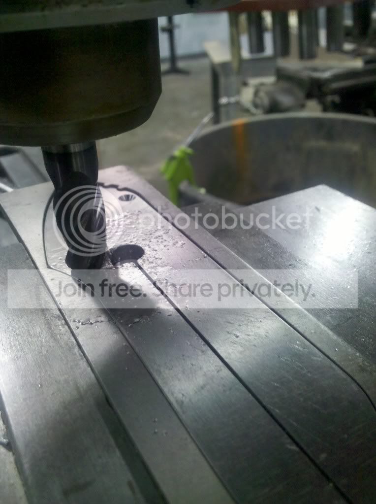

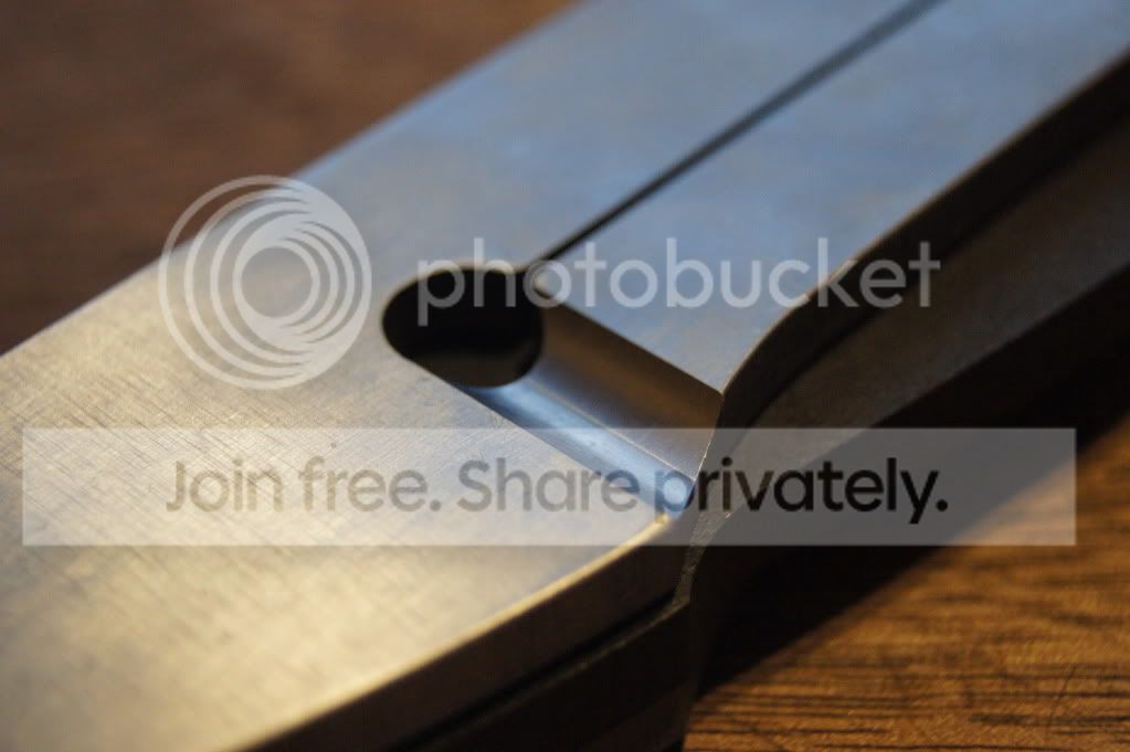

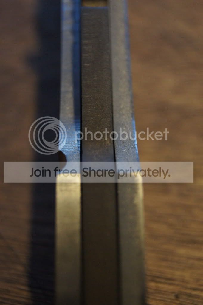

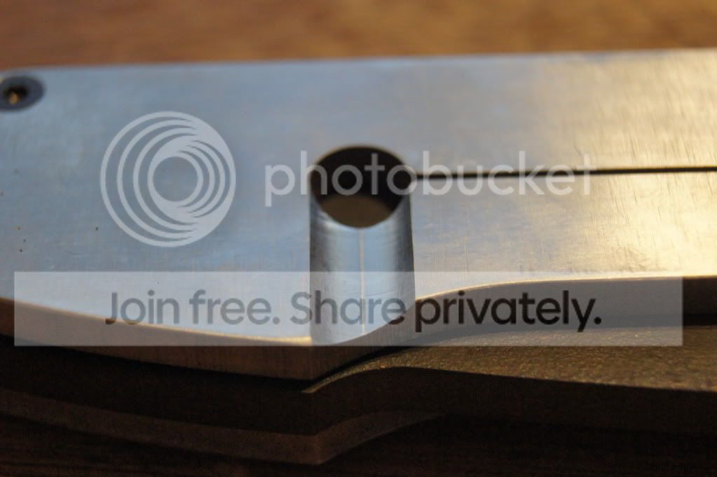

Used my carbide .5" ball end bit to mill out the lock bar relief. I was very careful in wanting the relief channel to match the hole in the lock bar arm and the apex of the handle. Unfortunately that meant the re-leaved area was a bit too thick. Fine for the proto but I will have to compensate on the production models. How much material do you guys think i should leave. Right now the lock bar is at .1". I'm thinking .06-.07" would make the unlocking easy enough without risking premature unlock.
.07 if not .09
Also... I'd be happy with 1095 as far as blade steel. This is epic no matter what steel you use!
1095 with a Hamon would be sick.

I would suggest going with .050-.060 for the relief on that lock bar. I have a pic floating around somewhere, with a 20lb dumbell hanging off of a hook attached to the lock face of a folder that I left at .100 for a guy and it didnt move much:) how strong are your thumbs?
+1 on a hamon
and the lock bar recess looks awesome

You have to go pretty thin on the lock relief when you do that style of cut.
.060" Max, I would probably start at .050"
You could also move it forward a bit, and it'll bend easier.
How long is the lock?
I'm 6'7" and 400lbs with hands the size of frying pans. So .100" isn't a big deal to me, hell I'd prefer an extra strong lock on a folder capable of hard use.
BUT
Everybody isn't me and I don't want to make this knife unlock-able for the "average" man. The production models will have a more manageable .06" size.
Lock is 3.793" from lock face to back of the circular cut out and the Ti is .190" thick.
