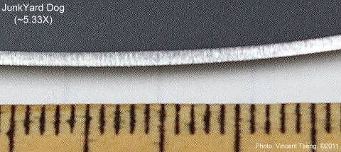

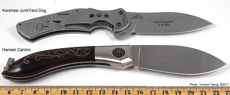

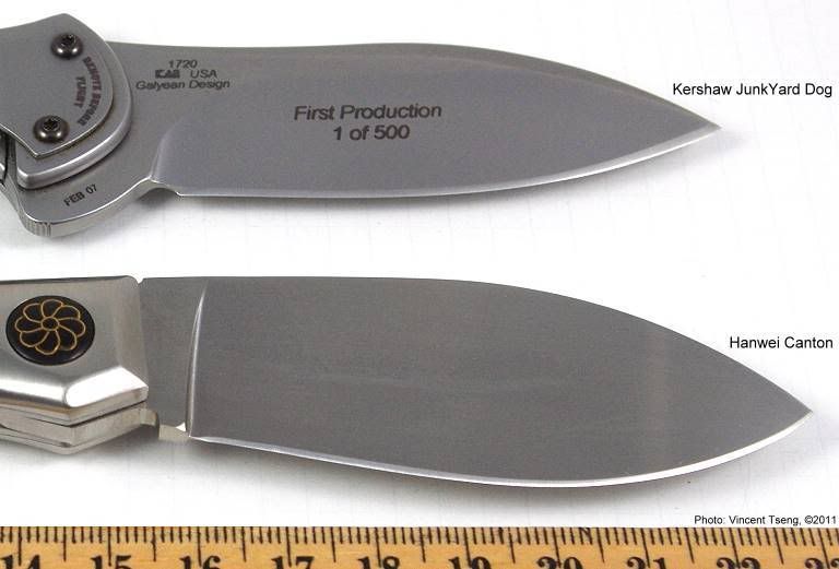

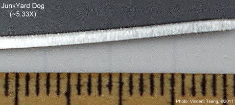

had to work a bit more on the Kershaw JunkYard Dog - did the blade straight up-down/vertical 20deg thing - but found that one side only ground the shoulder and didn't even reach the edge - so the original bevel or perhaps the blade face was not symmetrical - so used the P80 grit to re-profile that one side only until the bevels looks about the same/symmetrical - then finished off with P220 and 6000 grit belts.
The Hanwei Canton knife is in ATS-34 and custom made for me by Paul Chen of CAS Hanwei.
Details of JYD edge at about 5.33x life-size for PC monitors @ 96dpi or about 7.1x on Mac monitors @72dpi.

It was weird when using the Work Sharp on that JunkYard Dog - I could feel the burr almost immediately with the P220 but still did 3 passes each side before going on to the 6000 grit.
Although the blade was sharp it didn't feel quite as sharp as I was hoping - as the steel is Sandvik 13C26 (this was the earlier version/first production - before the switch to the Kershaw Sandvik special) - which is a well reputed razor steel.
That's when I examined the edge under a 30x illuminated pocket microscope and was shocked to see one side had only ground off the shoulder between the edge bevel and blade face and hadn't even reached the edge - so that one side had the original more obtuse bevel while the other side had the 20deg convex.
So I bit the bullet and ground with the coarser P80 belt on that one side only until I actually got to the edge (felt the burr) - then a bit more until the convex bevels kind of looked even/symmetrical - then finished off with the P220 - balanced the other side with a couple of passes on the P220 to knock off the burr then finally finished with the 6000 grit.
Pretty happy with the final result - although why the blade was asymmetrical is still a mystery -
as it is not that hard to hold a blade straight up & down/vertical -
since I do that all the time with a V-hone crock sticks.
