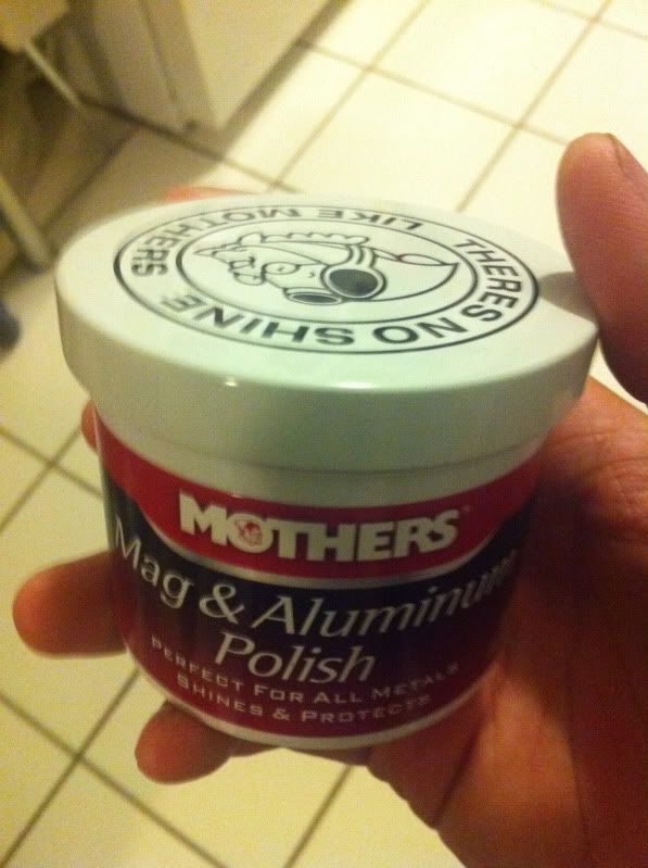

Noctis, that's a beautiful edge. Mother's Mag is indeed great stuff and I will give your suggestion a try. Did you apply just a small dab in one place or...?
I use a toothpick to spread a thin layer over the entire belt, like butter. Anymore than that and the polish will fly all over the room. I'd also recommend giving it a minute or two to dry off a bit. You can tell whether it's working or not as the belt will turn black from the metal.

I also eagerly recommend wearing out a spare 6000 belt with some P60 sandpaper(do it slowly, don't want to strip the cloth too) and putting some of this on it:
That stuff is magical. It'll shine up a cloudy edge in no time, yet it'll leave an edge that can tree-top leg/arm hairs and cut free hanging hair.
In my younger days I worked at a trucking company and the owner had me polish fuel tanks with mothers and you could get them like a mirror (with a lot of elbow grease). It is great stuff. It isn't working unless your applicator turns black. That means it's working!
