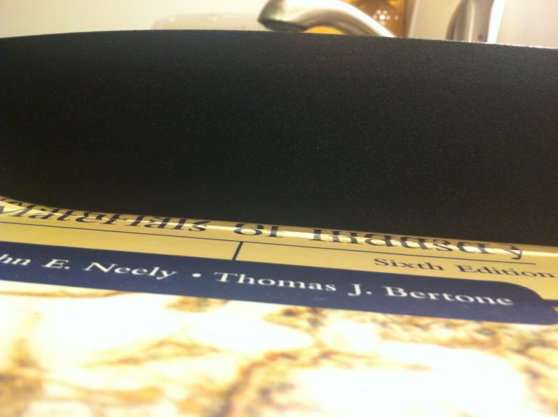

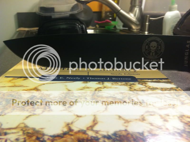

Though you guys might like this:
Sharpened up my Junglas because it wasn't sharp enough from the factory(just my opinion:D). It pops hair with ease, though it can't quite tree-top(either that, or my leg hairs are still too short:thumbup:). But guessing from the fact that it cuts through one of my longer hairs with ease, it's probably just because my leg is bald from all these edge testings;).
I also eagerly recommend wearing out a spare 6000 belt with some P60 sandpaper(do it slowly, don't want to strip the cloth too) and putting some of this on it:
That stuff is magical. It'll shine up a cloudy edge in no time, yet it'll leave an edge that can tree-top leg/arm hairs and cut free hanging hair.

Noctis, that's a beautiful edge. Mother's Mag is indeed great stuff and I will give your suggestion a try. Did you apply just a small dab in one place or...?
