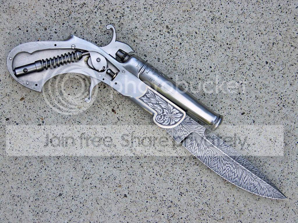

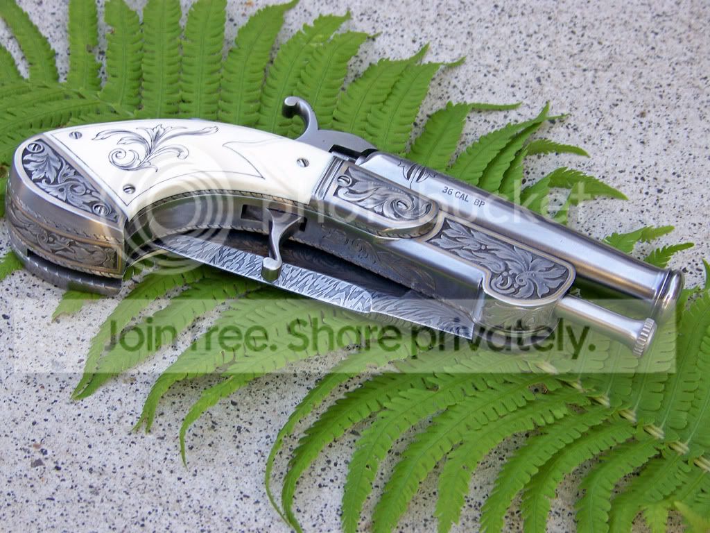

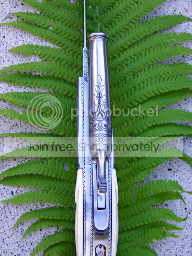

I have all the parts back from the engraver and have started assembling it for final fitting and making the screws. The engraving is especially nice on this one.
I spent some real time on the liner filework. There are 3 of them and thats allot of filing. Still need to clean to remove any and all oils from everything and do the french grey finish.
The next pics will be the finished gun/knife

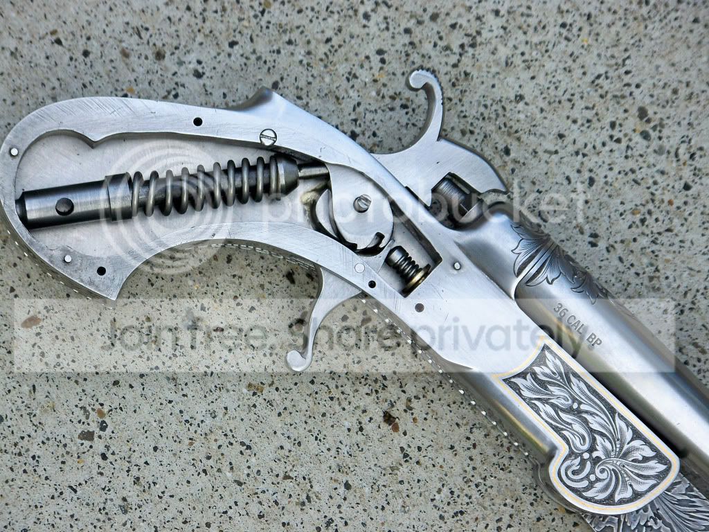

Here is one I thought you all would like. Its a coil hammer spring also the trigger pressure/return spring. The cool thing about this set-up is the tensions can easily be changed by shimming or grinding the spring lengths. Next pistol I think I will put an external adjustment screw on the pommel so fine tuning. Some brands of muskett caps fire easier than others so that would be a good feature to have.
Wow, just WOW! The engraving goes perfectly with the damascus and the spring set up is very interesting.
It'd be nice to have a picture of the same thing cocked -- I think I see what's supposed to happen, but might be wrong.
I dont have a picture in the cocked position because of the spring tension without the side plate to support the hammer pivot pin. I could take a shot of it without the spring if you like? The first position is half-cock (safety) and the second position is full cock (hold your ears)
