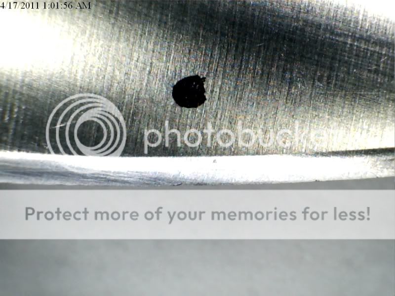

i decided to perform another test on my endura 4 ZDP. i figured the first test was me cutting metal cans why not try something softer. i took an old new balance sneaker (US made), size 12 and decided to cut it up. the edge angle was about 20 degrees per side. the rubber and glue was gumming up the blade, so toward the end of the test i was rubbing mineral oil on the blade to prevent that. i was hanging an inch of the shoe over the side of the table so the only thing the blade was contacting was sneaker. i believe i cut that sneaker into about 27 pieces.
before the test, the knife would easily cut newspaper against the grain. after cutting the shoe, the knife would barely cut newspaper with the grain (have to use a sawing motion). the knife still cuts cardboard decently.

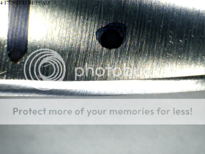

i decided to cut the other sneaker up using my spyderco para 2 s30v. i set the edge around 18-20 degrees, with the same stone i finished the ZDP with. the s30v would easily cut newspaper against the grain before the test, just like the ZDP. i cut the same sneaker as i did with the ZDP (just the other side). i also cut this sneaker into about 27-28 pieces just like i did with the ZDP. the only thing i did differently was that i oiled a paper towel and kept wiping the blade so it wouldn't get gummed up. i didn't use oil on the ZDP until i was close to the end of the test. this caused me to use some more effort with the ZDP as opposed to the s30v.
this is the edge and the part of the edge i marked before the test, 40x-50x magnification:
s30v
this is the edge after the test, 40x-50x magnification:
s30v

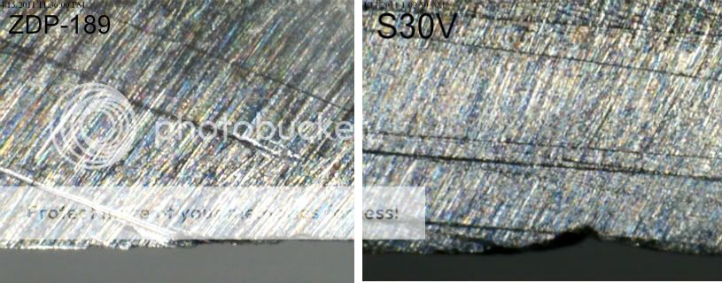

this is the edge at 375x magnification. the s30v took on more damage than the ZDP. also, the s30v wouldn't cut either paper or cardboard after the test. ZDP had some trouble with newspaper, but still cut cardboard pretty easily. note the scoring on the edge just like the ZDP had. i don't know if that is caused by microscope pieces of s30v getting caught in the rubber or if the rubber has abrasives in it (example: they use silica in the rubber for car tires).

In your last pictures at 375x magnification, was that the ZDP or S30v blade? Would you mind taking a picture of both of them as you're taking comparative pics and varying the blades at different magnifications. I'd like to see both blades at the same magnifications. Thanks. :)
Hi cziv -
Post #55 is identical to post #63 excepting that #55 is the zdp and #63 is the s30v.

mqqn is correct.
i made sure that all magnified pics have what steel is pictured listed in the top left hand corner (above the pic). also, if you look at the photo link, the pic's name has a description of what it is.
just to help you out cziv, this is a side by side of the ZDP and s30v at 375x magnification after each shoe cut test.
Thanks jimnolimit, Guess these old eyes need to get new glasses. I can see something now that you mention it, in the corner, but I can't make it out. I can read the text above it though and missed that. Good comparative tests! :thumbup:

With S30V being the "tougher" of the two steels, its interesting that it took more damage during the shoe cutting test. I would have thought the opposite to have happened.
