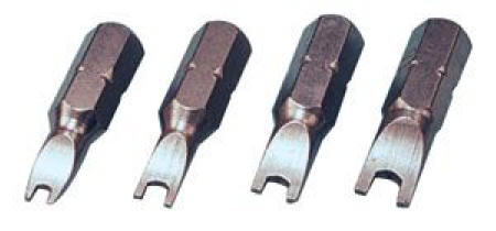

I have taken several Hinderers apart using these security flat head bits:

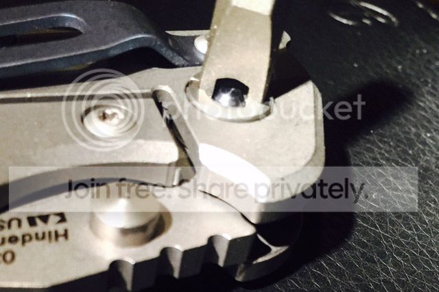

How do you guys stop from marring up the slot on pivot screw with a flathead screwdriver? Cover flat edge with elec tape?
Use an appropriately sized screwdriver. I don't care if the inside of the slot gets marred (they already aren't perfect from the factory), but if you use a blade that's the right size and doesn't slip, it'll be fine.

I just found this thread which was was really helpful. You need a #10 spanner. I wish I had done some more research before buying a Hinderer tool for my XM-18.
http://www.bladeforums.com/forums/showthread.php/736023-Spanner-bit-size-for-Hinderer-XM-18
Not sure you read the whole thread thread you linked to but as I said earlier, a #12 spanner is what you need (or it sounds like a 14 if you work on it with some sandpaper). I've tried a 10 and the gap is to small and didn't fill the slot well. Most of the time people muck up flatheads is because they are using the wrong size of wrench. Fill the gap and it won't slip. Photo evidence below ;-)
http://s206.photobucket.com/user/euthymic_one/media/12Spanner_zpstncm1kas.jpg.html
Sorry about that. I didn't read the whole thread and I missed your recommendation regarding the need for a #12 spanner. Thanks for the info!
From Above "You can usually get it from most hardware stores. This set is from Harbor Freight, but it gets the job done."
Beware... All the cheap "security bit" sets that I've seen (including the HF model linked above) only come with a #10 spanner. It might work in a pinch but unless you don't care about your finish (and I don't think you would be asking here if you didn't), throw down the $3 and get a proper #12. Just search a parts supply house like grainger and you should be good to go. I've found the cheap "security" bits to be universally terrible in all aspects (fit, slop, quickly deforming). Just want to help prevent people from picking up the wrong tool or from having the wrong information continuing to be regurgitated.
