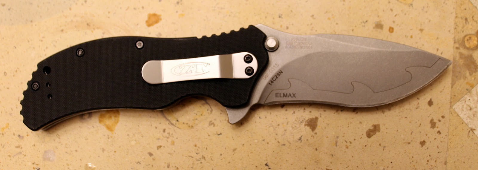

... the braze line looks really cool.
Sure does! Some with even greater wow factor!
Sorry, I tend to lump Kershaw and ZT together without really thinking about it. The 0350CB isn't current production, but it was a CB.
If the knife is going to break, it'll be the tip. These aren't swords, they have zero flex. So I don't see any real benefit of CB blades, other than the fact that they look cool.
So, there are no advantages in cost or weight or blade strength at all for Composite Blades?
The cutting edge is what counts. Perhaps it is more cost effective to use a small amount of the expensive steel where it counts rather than make the whole blade from it. For knives that are made to have no flex at all, which is pretty much all folding knives, I think it's purely aesthetic. I suppose you could avoid cracking around the thumbstud area with a softer steel there. I have a ZDP-189 blade that cracked at the thumbstud. But thats pretty rare anyway. I love CB blades. They look awesome and exotic. Especially the Sandvik/D2 combo. The contrast looks interesting and it's fun seeing people reactions when I show them my CB d2 leek. I wish other makes would do the same.
