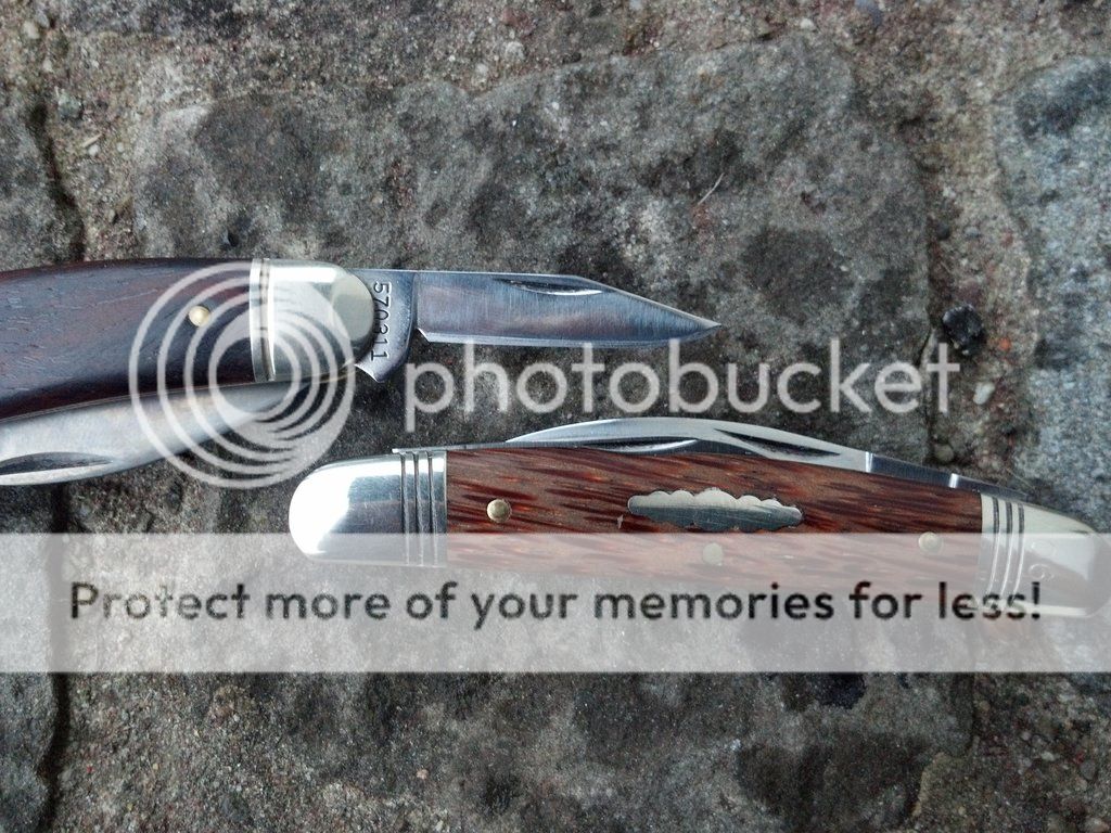

I'm thinking a drop point blade, but the size of a pen blade. The pen is like a small spear with the tip in the center..... move the tip higher up and you get more belly..... that's a drop point.
I like the idea of using something other than a pen blade secondary. However, I think getting the blade tip of a drop pt below the liners might prove difficult without giving the blade having a high run up.
I wonder if GECs little clip blade they've used on the 25s would be a better option?
A Serpentine Swell End Barehead Congress Jack or SSEBCJ, doesn't that just roll off your tongue?
For reference (top two knives/blades):
~ P.
I have to disagree there, I think it looks pretty good, and would solve the issue of those wanting more belly than a pen.
Honestly, I think you could work with that pen (make it longer and bring the sharp edge lower) and you'd have the drop point. The clip just looks funny to me. Maybe if you took that shape, but lengthened the blade.
Here's another version of a small clip which might appeal to you more. Nothing against your WLST® Sarah (or whatever it was) :)
But I think the main problem is to keep the tip in the frame. As you can see it's already really tight with the pen blade, which has the nail nick further forward than the clip (and even then a cutout is needed).
Of course there isn't. :p
Just to be clear, I'm not proposing or recommending the clip blade as seen as a secondary on the #25s-- or better yet, similar-but-elongated-- just providing an existing picture for illustrative purposes.
~ P.
I like that version as well. I think the semi-consensus is for a blade with more belly to offset the straight lines of the probable primary blade (sheepfoot or wharnecliff). The more you drop the point on any of these will serve to straighten the cutting line and thereby do away with the intent (belly) of it to begin with. I am sure there is a happy medium somewhere, just not certain where it is.
