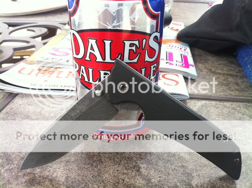

I absolutely love my Damascus skyline !! :D
