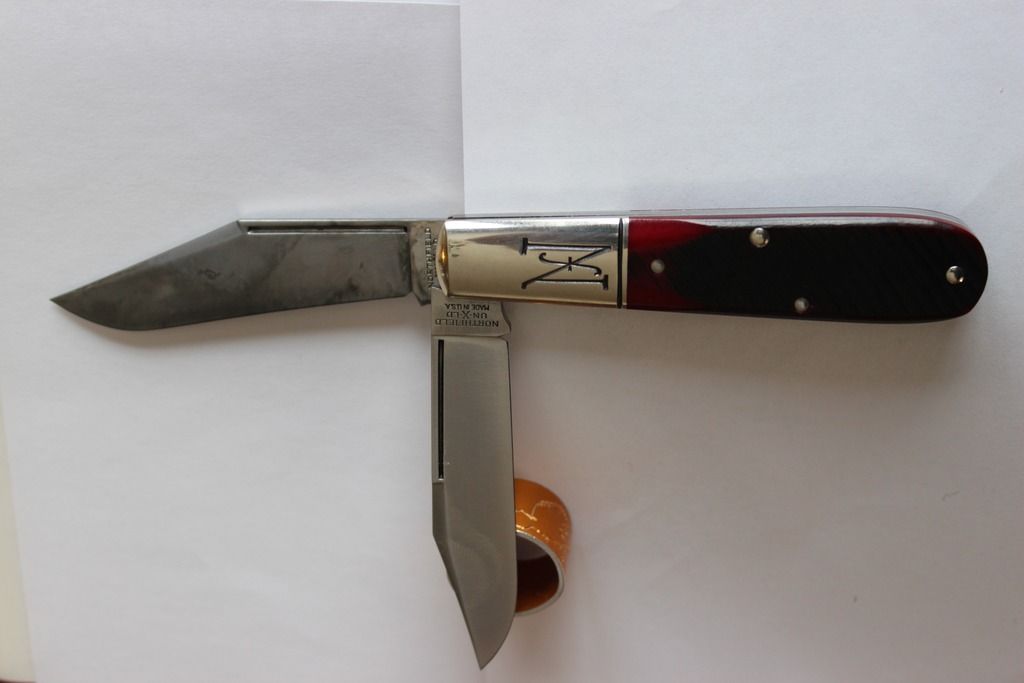

As for blades, I have to agree with Tim in that caplifters have been done to death, and they really don't fit with this knife anyways. A caplifter on a 77 barlow would feel very gimmicky to me. I really like the combination of the spear and coping blades on the last run. My biggest criticism, and it's really a small one, is that I wish the spear was pinchable. It seems like it would have been very easy to take a little bit off of the coping or shorten the swedge on the spear a little, which would have made it very easy to pinch open the spear. To avoid repeats, I'd like to see a reversal of these blades and have a sheepsfoot/wharncliffe main with a pen secondary. Ideally, a wharncliffe like the first run you made, except with the swedge ending before the nail nick instead of after it. This would allow for a nice deep nail nick and would allow the main blade to be pinched open. A healthy pen secondary, about the same length as the coping on the last run, would compliment this blade perfectly.
